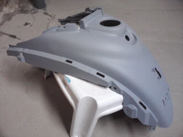

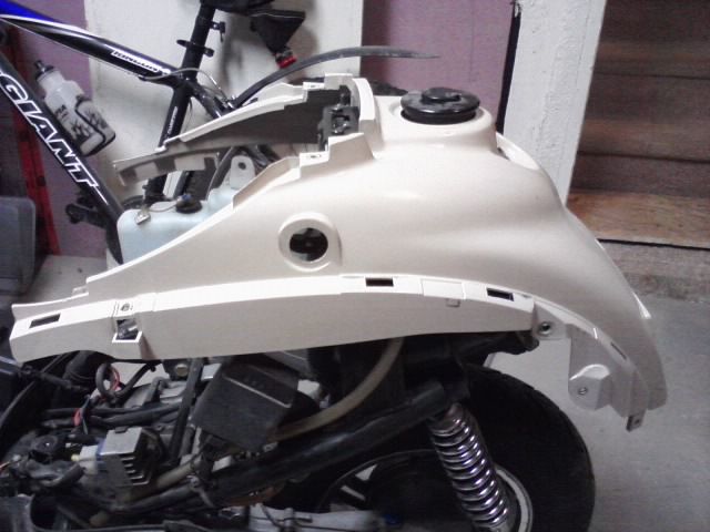

            panels done.

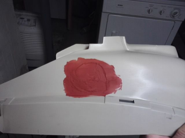

            issue, right arm that wraps around the seat bucket seems to crack when removing/re-installing so a key delete is in order...key fix to follow
            fresh jdm panel
            fill in the spot with a cut out piece from the original panel and putty
            fiber glass the inside for reinforcement
            sand and mold then primmmmmmmmmmmmme
            finished

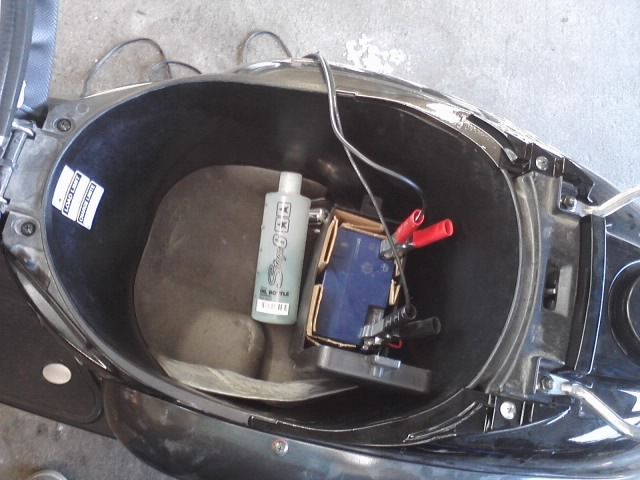

            battery relocation done up, more power!
