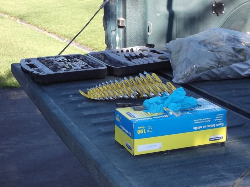

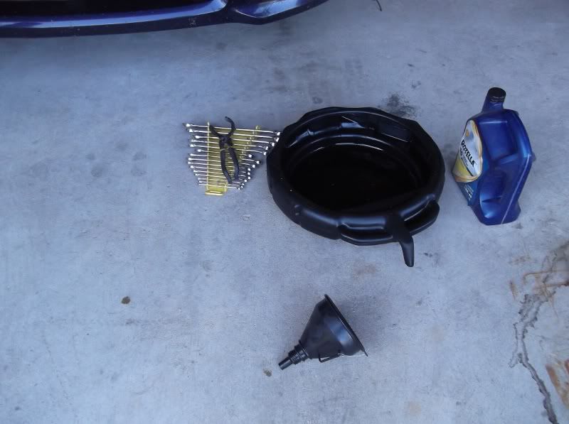

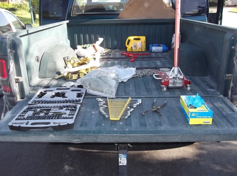

Here's what you'll need:
- A drain pan.
- Rags or towels
- Funnel
- Something to lay on, like cardboard
- A socket/wrench set for removing any splash shields or factory aero to access the oil filter, and for removing the drain plug
- A filter wrench is often handy, especially if you've had your oil done at a shop or dealer (they tend to crank the filters on insanely tight)
- Gloves are highly recommended, you can get a pack for cheap from Costco, CT, anywhere. The oil is, or should be hot when you change it, and used oil is a carcinogen (cancer causing agent)
- A floor jack and stands, or ramps, will help to get the car in the air. USE THE STANDS, DON'T CRAWL UNDER YOUR CAR WITH JUST A JACK HOLDING IT. Follow all safety precautions/jacking instructions in your owners manual. Cars have specific points on where to jack them.
- Beer and friends are always good to have.

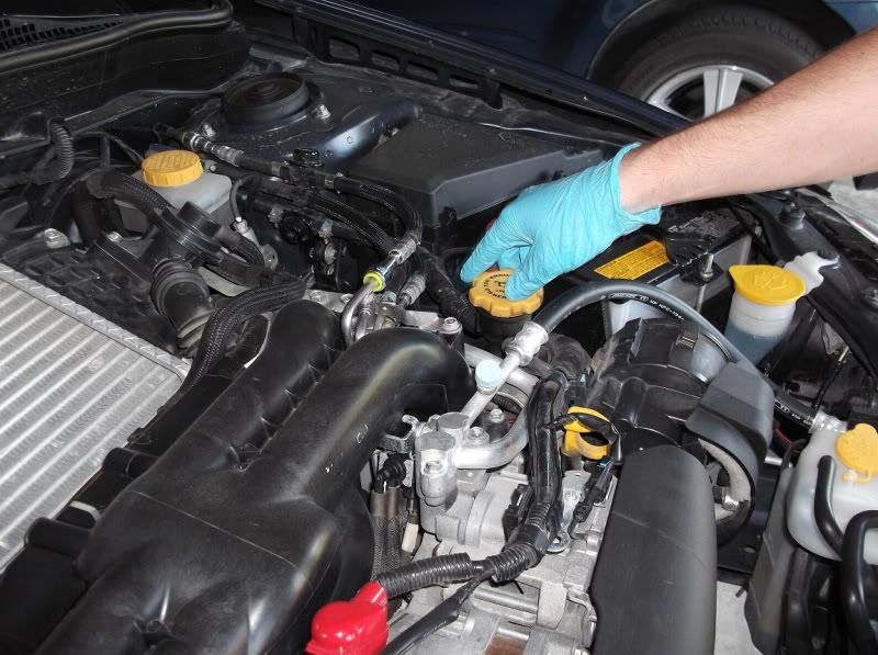

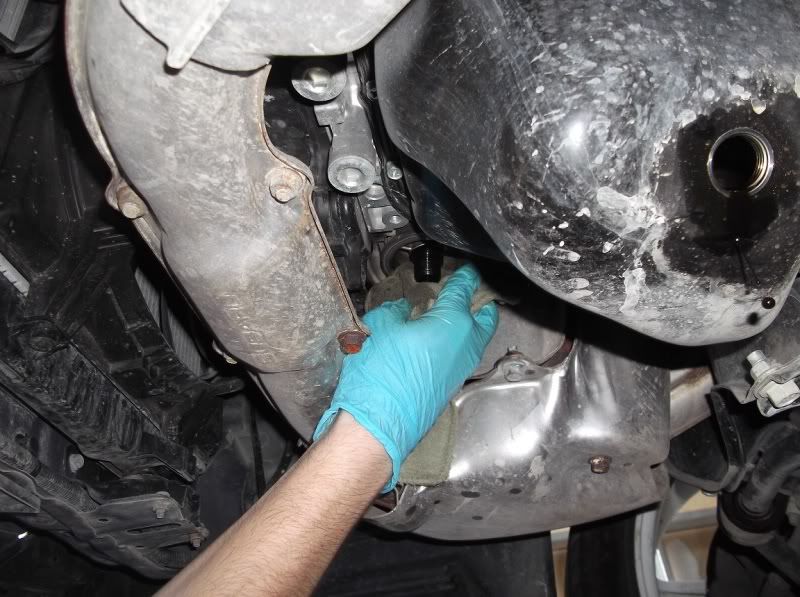

First I always remove the engine oil cap and dipstick. This helps vent the crankcase and drain the oil out smoothly. Like loosening the little cap on a jerry can of gas.

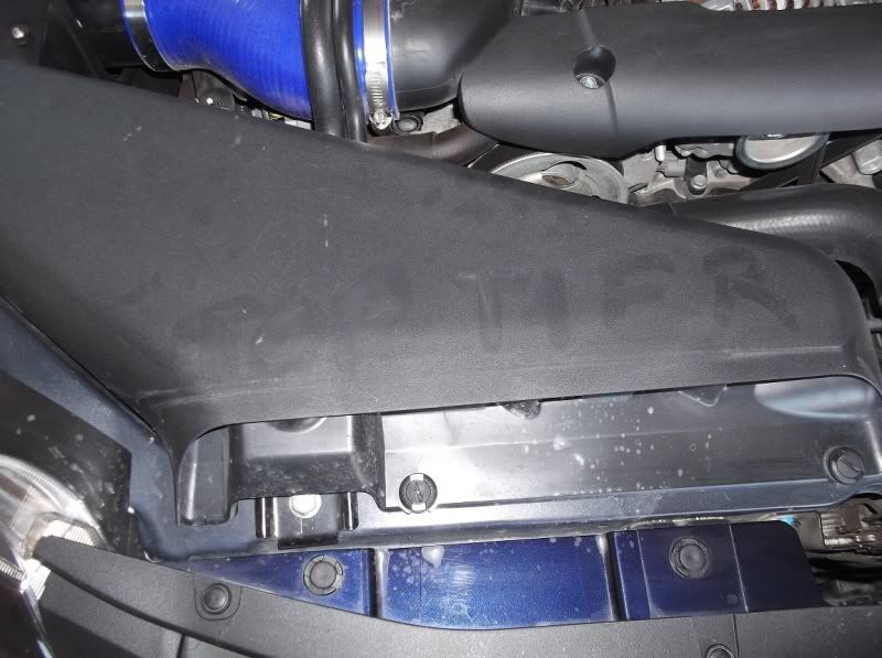

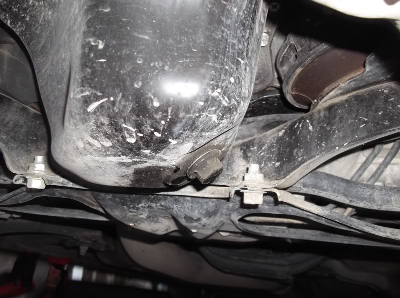

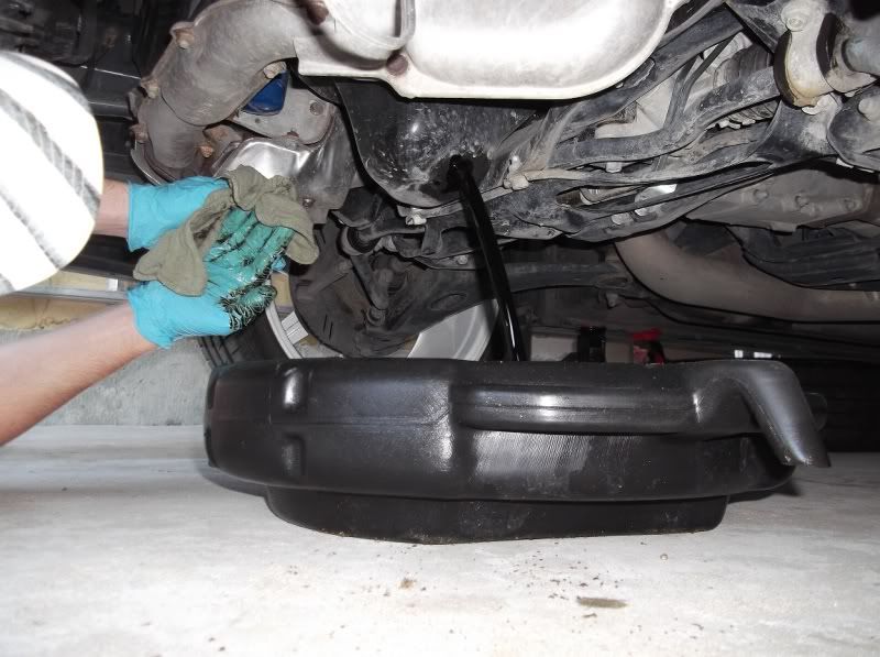

We've already removed the underbody splash shield/aero panel, so we can access the drain plug and filter. The drain plug is located on the bottom of the oil pan, usually at the rear of the pan. Put your gloves on, and crack it loose with a wrench or socket. Take it out with your fingers and place it in a rag, while the oil drains into your drain pan, pail, whatever you have. Careful not to burn yourself.

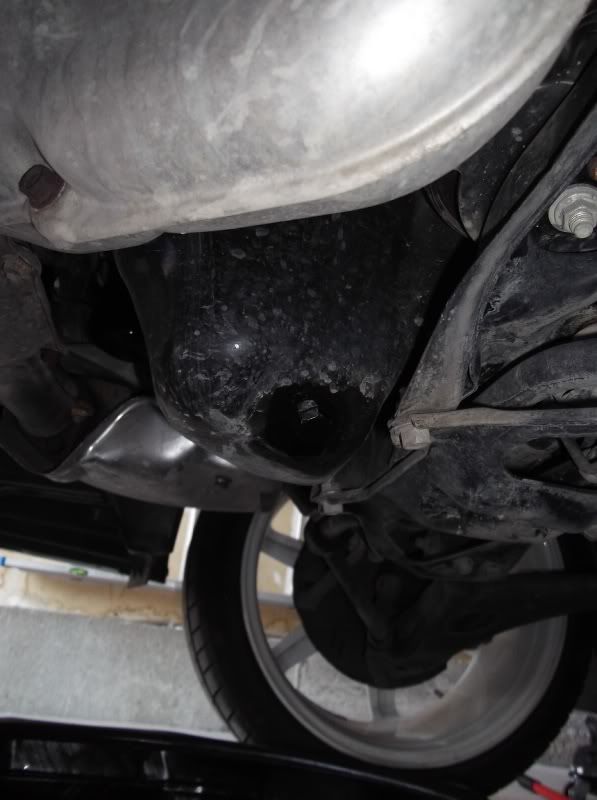

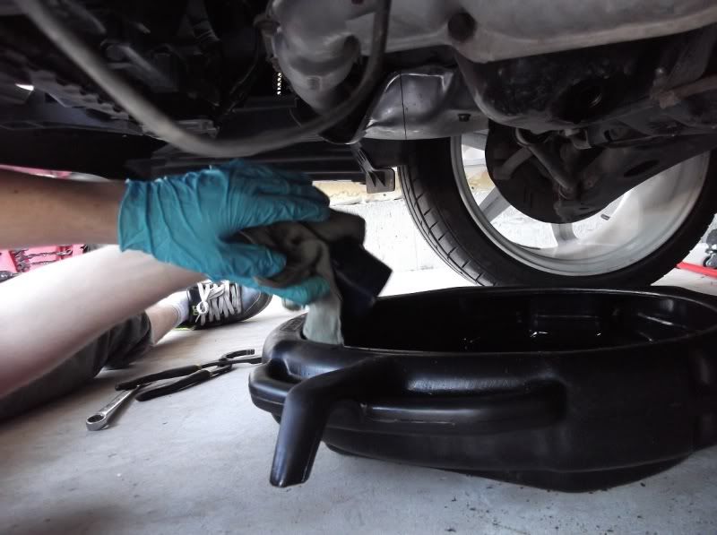

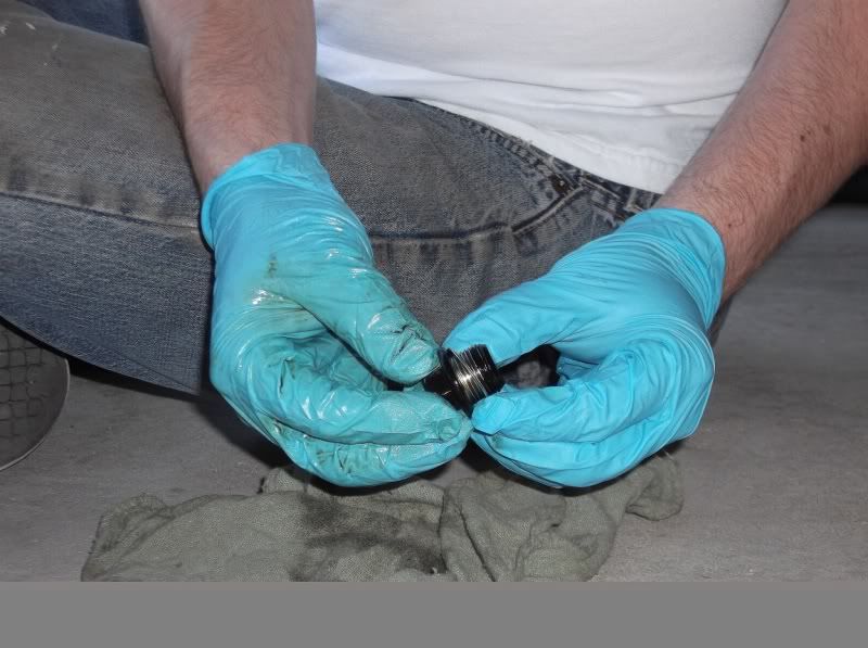

The drain plug washer is 50 cents. If you want to reuse it and it looks in decent shape, reuse it. If its cracked and beat up, get a new one.
Let the oil drain into your pan. Take a rag and wipe the plug and washer clean. During this time you can check your tire pressures, fill your washer fluid, check your transmission oil, check your air filter, etc. Wait until the oil is a slow drip to put the plug back in.

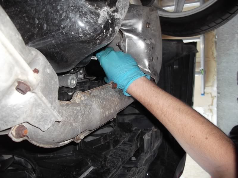

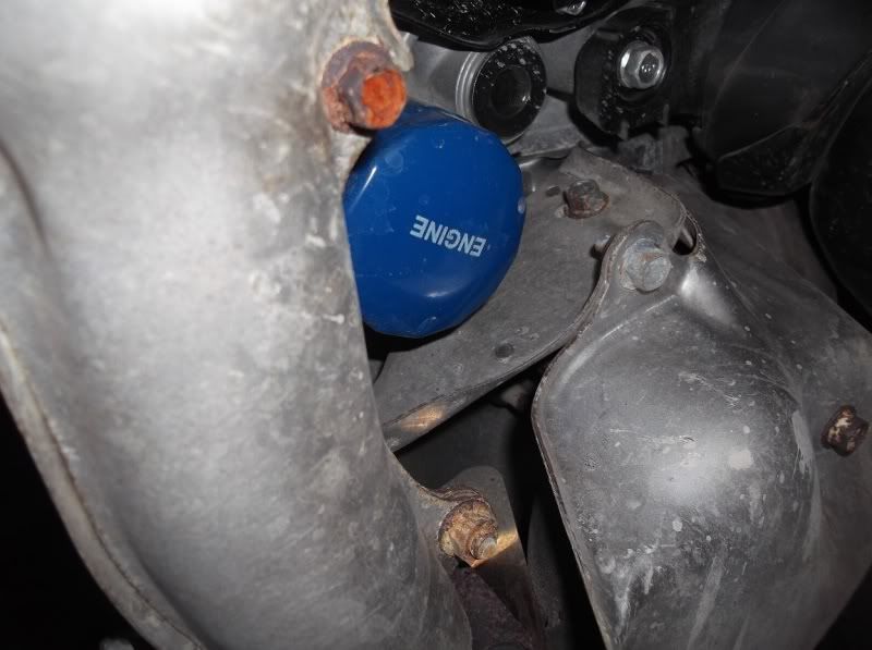

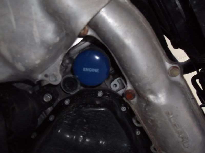

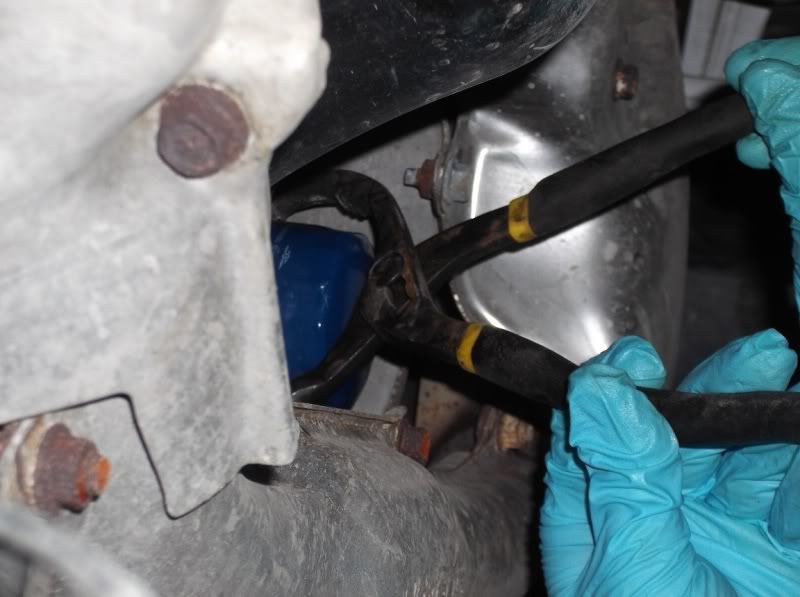

After that you can find your oil filter and remove it. The filter on this vehicle is tucked behind the exhaust pipe/manifold, roughly in the center of the engine. Since it is so close to the exhaust on this application, (:unamused:) the filter also gets quite hot.
If its on there good and tight, use your filter wrench to remove it and dump it into the pan.
Look at the filter base on the car and make SURE the old gasket came off with the old filter. If you put a new filter on and the old gasket is still on there, it will leak all the oil out in a manner of minutes.
Wipe the filter base clean.

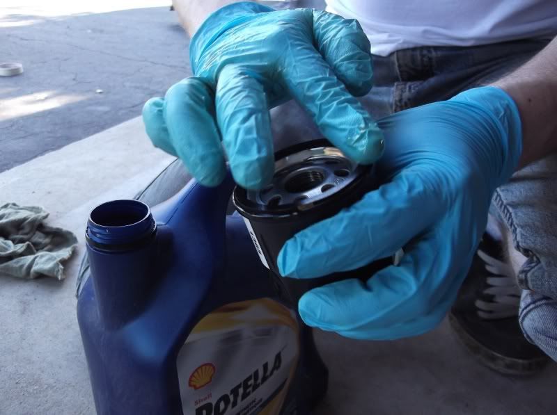

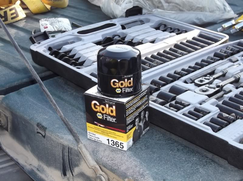

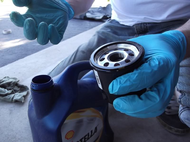

We are using a Napa Gold (Wix) filter, along with Shell Rotella T6 full synthetic oil.
Take your new filter and lubricate the new gasket with a thin smear of clean engine oil.
Spin it on and hand tighten it a few turns.

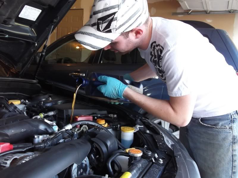

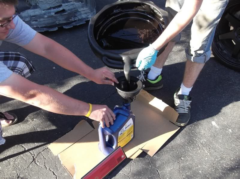

You can lower the car back down and start filling it with clean oil. Don't empty the whole jug into it, look up your cars oil capacity. If you're confident about your depth perception, you can risk not using a funnel, lol. Didn't miss a drop!

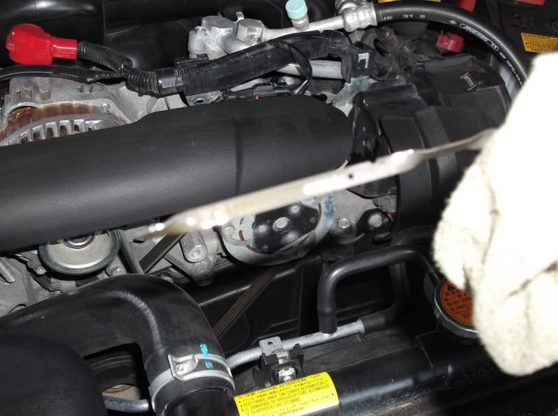

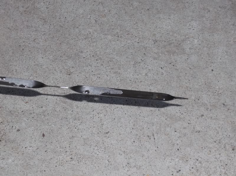

Once we had 4L or so in the car (capacity is 4.2L I believe), we put the cap and dipstick back in.

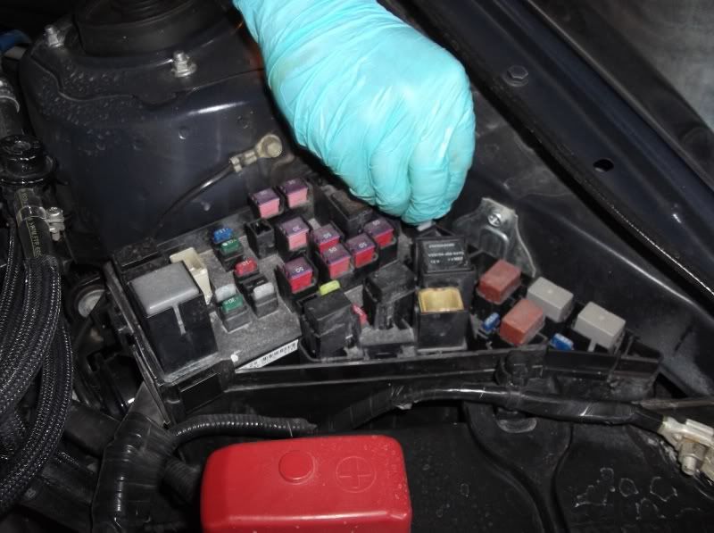

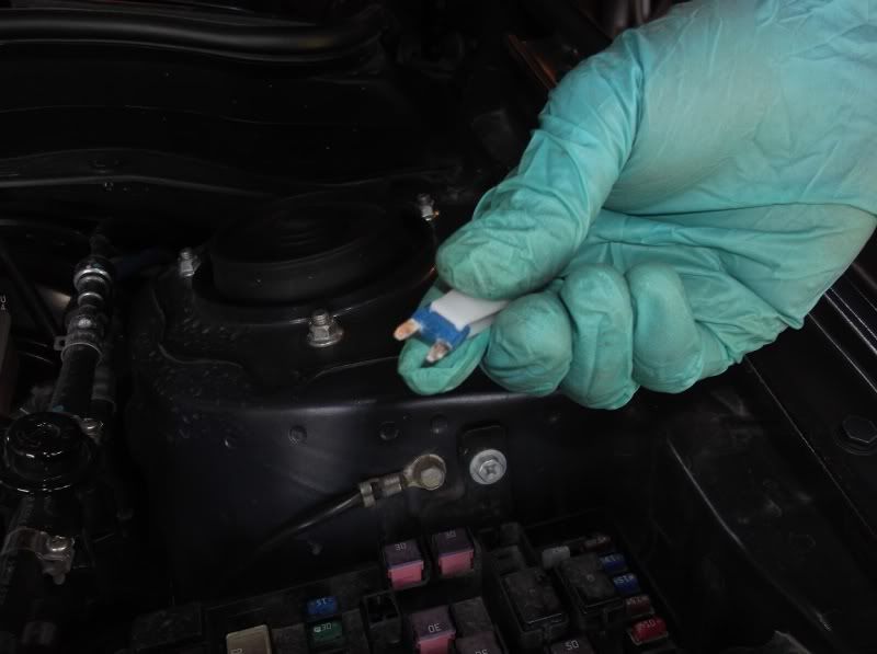

Since this vehicle is turbocharged, we don't want the turbo to run dry of oil, so we have to prime it (this is not required, this is something I do because I'm fastidious about such things). We do that by removing the fuse for the fuel pump. Without fuel, the engine will crank and pump oil without starting. This is not required for vehicles that are naturally aspirated or supercharged.

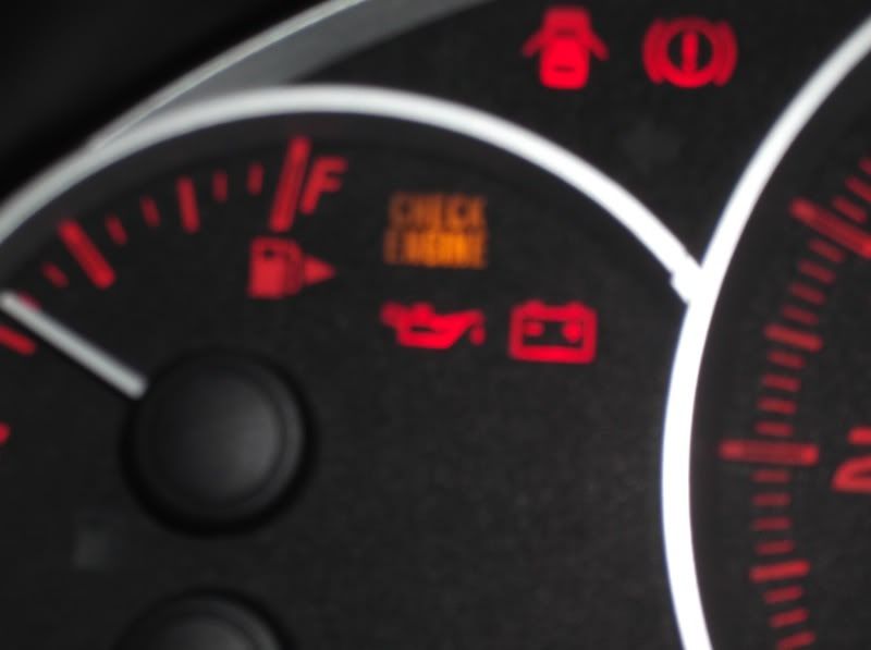

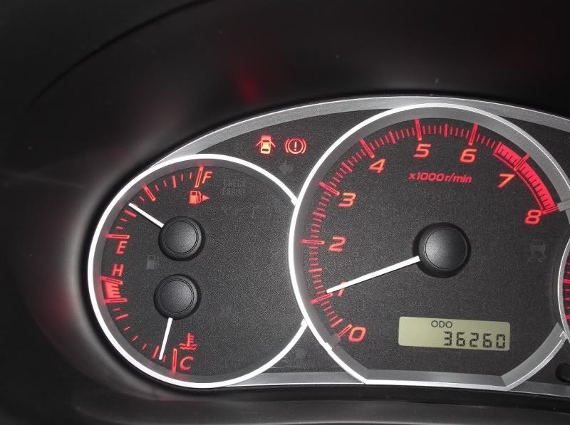

Go inside the car and turn the key to the RUN position. Your cluster will light up, and you will see the oil pressure (not oil LEVEL) light turn on. You can start your car, or in our case, crank the car over for 5 seconds or so. Let your engine run until you see the light go out, meaning the oil pump has built up sufficient oil pressure.
Once the light goes out, usually after running for 10 seconds or so, you can shut the engine down (and put the fuse back in, if applicable). If the light does not go out after 5-10 seconds, shut the car down immediately and check for leaks/oil level. Pull the dipstick out, wipe it clean, then re-insert it, and pull it out again to see the oil level.
The pictures didn't focus well at all, but you should see two small holes at the end about 2cm apart. The distance between the holes is equivalent to 1 litre. If your level is at the lower hole, it will take exactly 1L to bring up to recommended level. If it is halfway, 1/2 a L, and so on.
After you're done adding (or draining, if you added too much), put the cap in, check all your other fluid caps, put the dipstick in, close the hood and check for leaks, you're done!

      I've never heard of anyone pulling fuses to crank the engine over to prime the oil system...can't hurt but I personally don't see the need...in fact most turbo's are higher than the crankcase in which the oil will drain back to the crankcase every time the engine is off.  Turbo's that are lower than the crankcase (like mine) are usually equipped with a scavenge oil pump/system that sucks oil from the turbo center housing and pumps it back to the crankcase...when the engine is shutdown the scavenge oil pump will run for an extra 10seconds thus pumping the bearing of any oil (otherwise the oil will pass through the bearings into the intake/exhaust during sitting/cooling of the unit)
      Now priming the oil system for the first time that an engine ever has ran (fresh rebuild, etc...) is a good idea...after an oil change not required.
      If the OEM says however that this is the procedure for changing the oil on your car then follow it.

        ^ id have to agree, (not about CanadianTire and such places not changing the filters)
        "The oil pressure generated in most engines should be about 10 psi per every 1000 rpm, peaking around 55-65 psi.
         Local pressure (at the crankshaft journal and bearing) is far higher than the 50, 60 psi, set by the pumpís relief valve, and will reach hundreds of psi."
        that being said im sure my 2 turbos will get their oil quickly by just turning on the engine and not stepping on the gas, they really dont spool at all @ 800rpms.

                The fuse pulling bit you posted is fine, I wouldn't personally do it either (mostly because I'm lazy), but viscosity, filter brands, winter/summer oil discussions aren't meant for this thread.

                    Commander is right, it is not required, and I've edited the original post to reflect that. It is something I do because I have ridiculously high maintenance/engine standards in general. It is also something that I have in fact seen in an owners manual. People can choose for themselves if its worth it or a waste of time.

                      ^ Even though its not required, seems like a good habit to get into.
                      If a couple seconds of your time keeps your turbo in better shape, then why not?

                            I'm picky about some things too.  If you fill the filter with oil and let it soak in, you'll find you can put a lot of oil in it.  If the filter sits like on the Subaru shown, you can pretty much have it full of fresh oil, just waiting eagerly to be circulated around the engine.  If the filter is horizontal, you can dump out the standing oil and install it with all the filter media already pre-soaked.  It cuts down how much time it takes for the bearings to get oil either way.
                            If you have an engine that's prone to having the oil filter spin off under vibration (Honda S2000), you can wrap the filter with a hose clamp and safety-wire the 'tail' of the hose clamp to whatever is in the area so that the filter can't unscrew more than a few degrees before the safety wire stops it from turning.  This is really cheap insurance for those cars that may need it.  My Subaru doesn't get this treatment.

                                Corry we did fill the filter with clean oil, I just failed to mention it or take pics. I always do this with vertical filters. Especially my truck, which takes a liter and a half in the filter alone.
                                  July 09, 2012, 03:50 PM #17
                                  • Posts: 6,350
                                  • Reputation Power: 193
                                  Is this only necessary on vertical filters?
                                    July 09, 2012, 04:09 PM #18
                                    With the filter mounted any other way the oil will pour out.
                                    Its not necessary, but on big filters like my truck, instead of waiting for the oil pump to pump almost two liters of oil into it, its already full. It lets oil circulate faster on the initial start.
                                      July 09, 2012, 04:59 PM #19

                                                Word to the wise. Just did an oil change on a Mitsubishi. Oil filter is set up just like your Subaru. Double check the part number on the oil filter and make sure it matches. Someone switched the part numbers on me. Had to run out and buy a brand new one.
