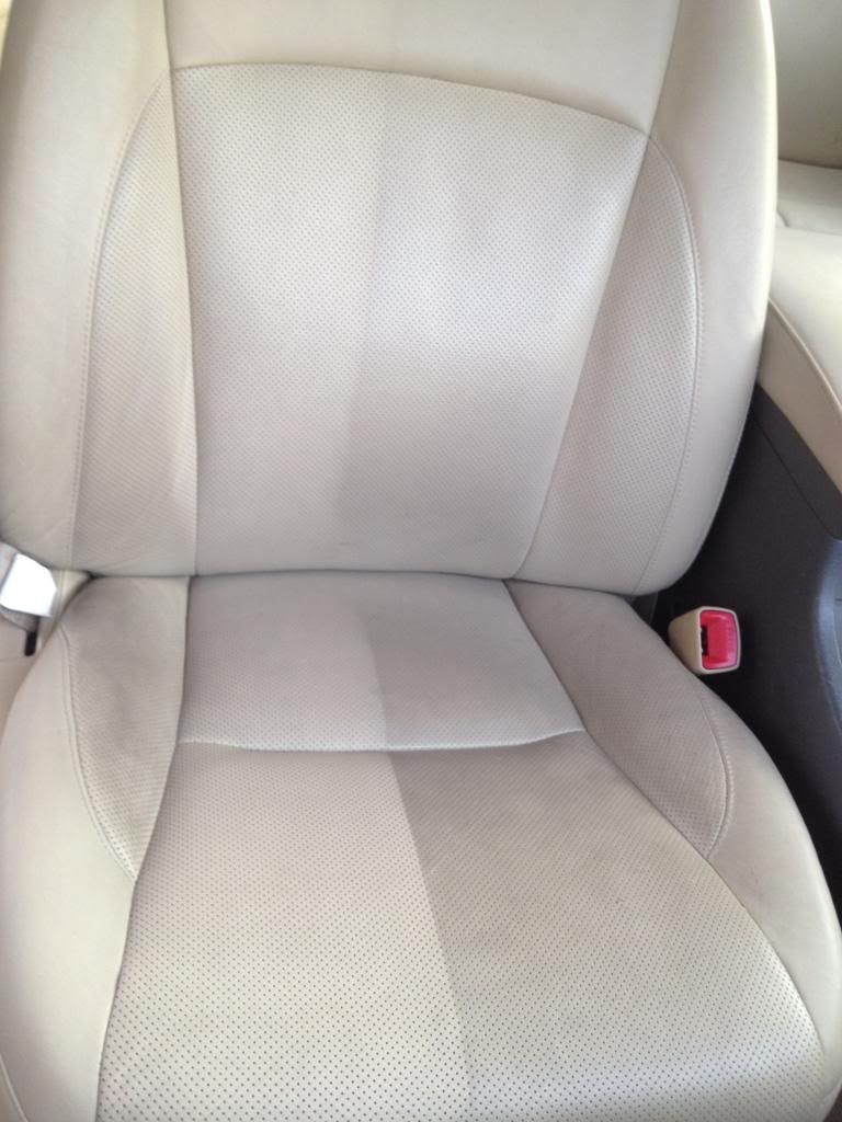

    Pinnacle leather clean, leather brush to agitate, and plush microfibres to wipe up. Lexol leather conditioner used to replenish healthy oils

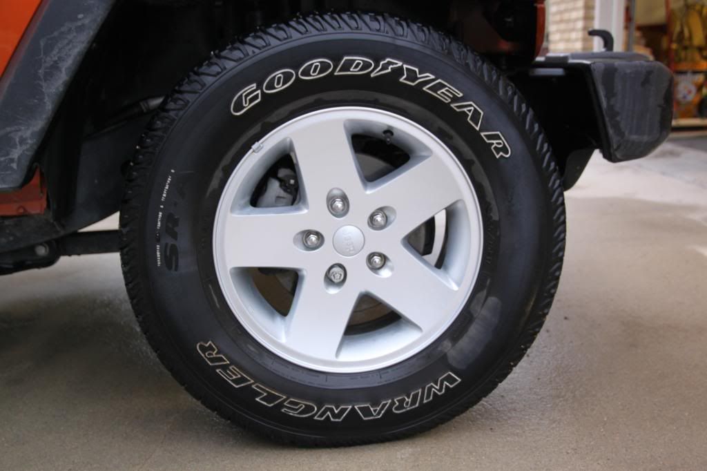

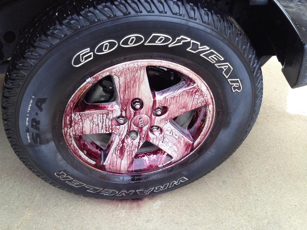

    Heavy brake dust removal on a 2012 Jeep. Sonax Full Effect and various brushes as well as 0000 steel wool in some places because it was so bad. Those places were polished back with M105

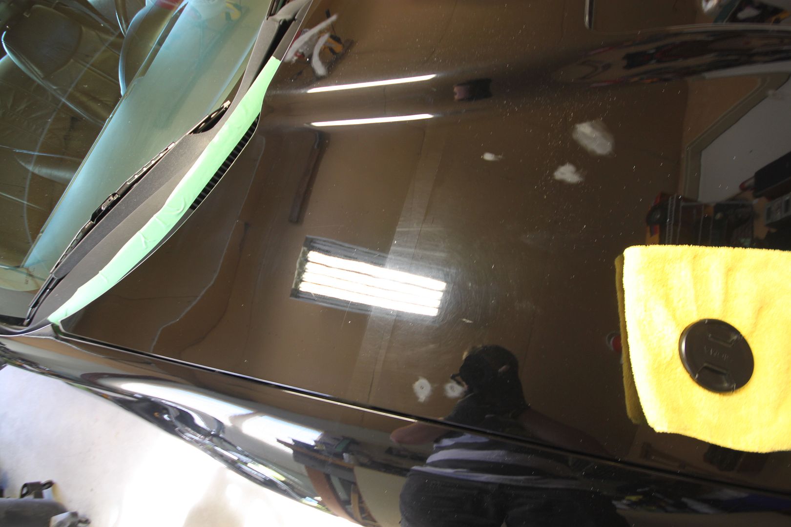

        Not so much detailing. But taking care of some dust in a hood. Took it down with 1200 grit.
        Photo taken with some residue left on.
        Last Edit: November 15, 2015, 09:34 PM by cluelessk

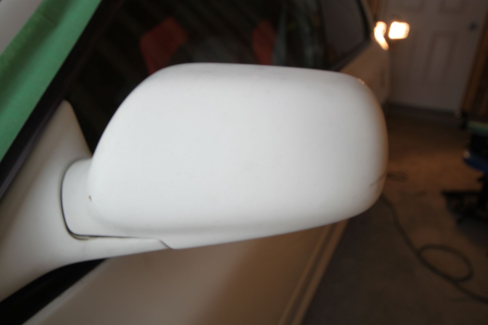

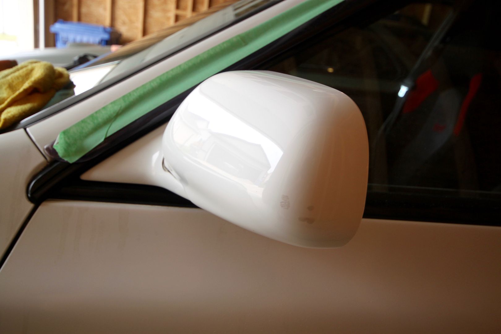

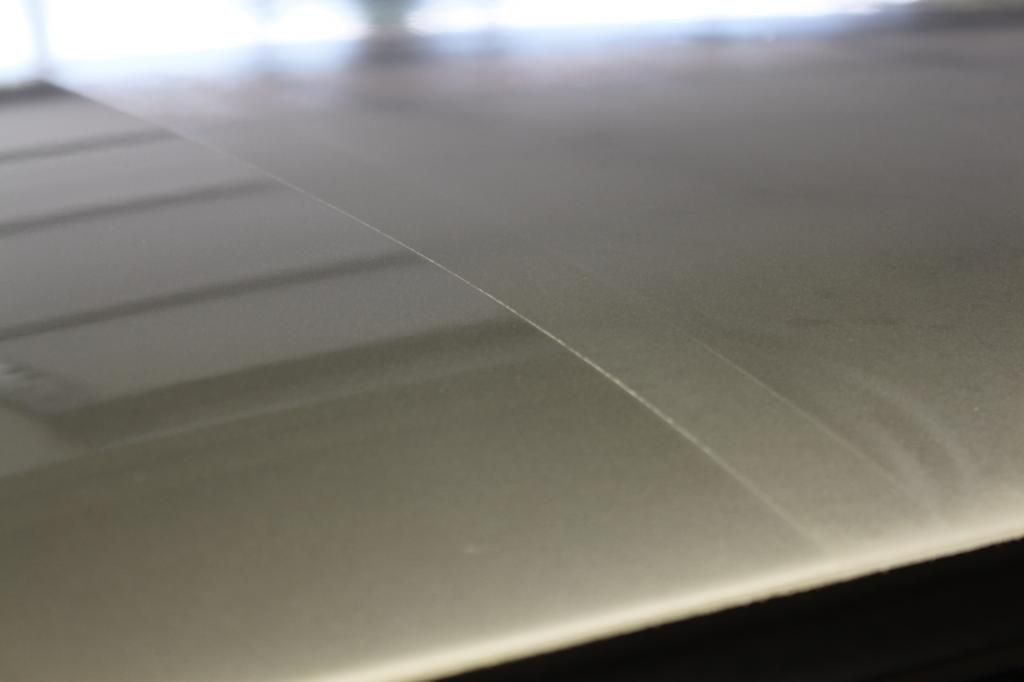

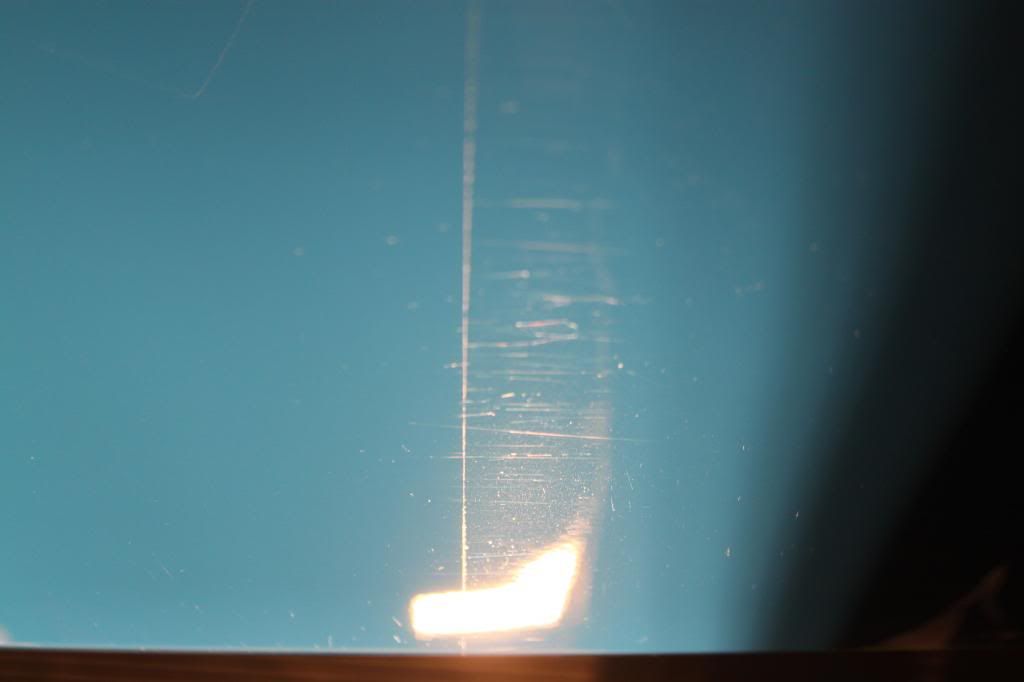

                                      Testing out my new polisher I just picked up a week ago.
                                      Took a red scotch brite pad to the paint and see what I could do on one of my vehicles.
                                      Before:
                                      After:
                                      Before:
                                      After:
                                      Scotch pad before:
                                      Scotch pad after:
                                        July 03, 2016, 07:54 PM #19
                                        • Posts: 1,119
                                          Location: Grunthal
                                        • Reputation Power: 19
                                        • cluelessk has no influence.
                                        Ugh. I'd really recommend against purposely damaging your paint to see how well you can correct it.
