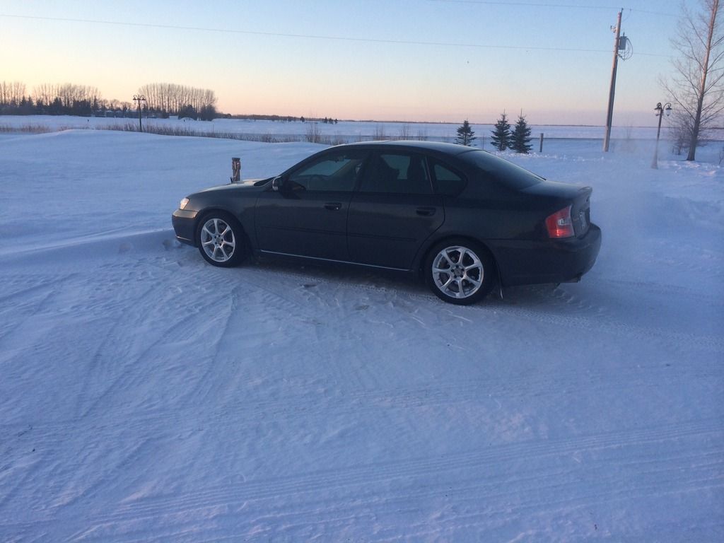

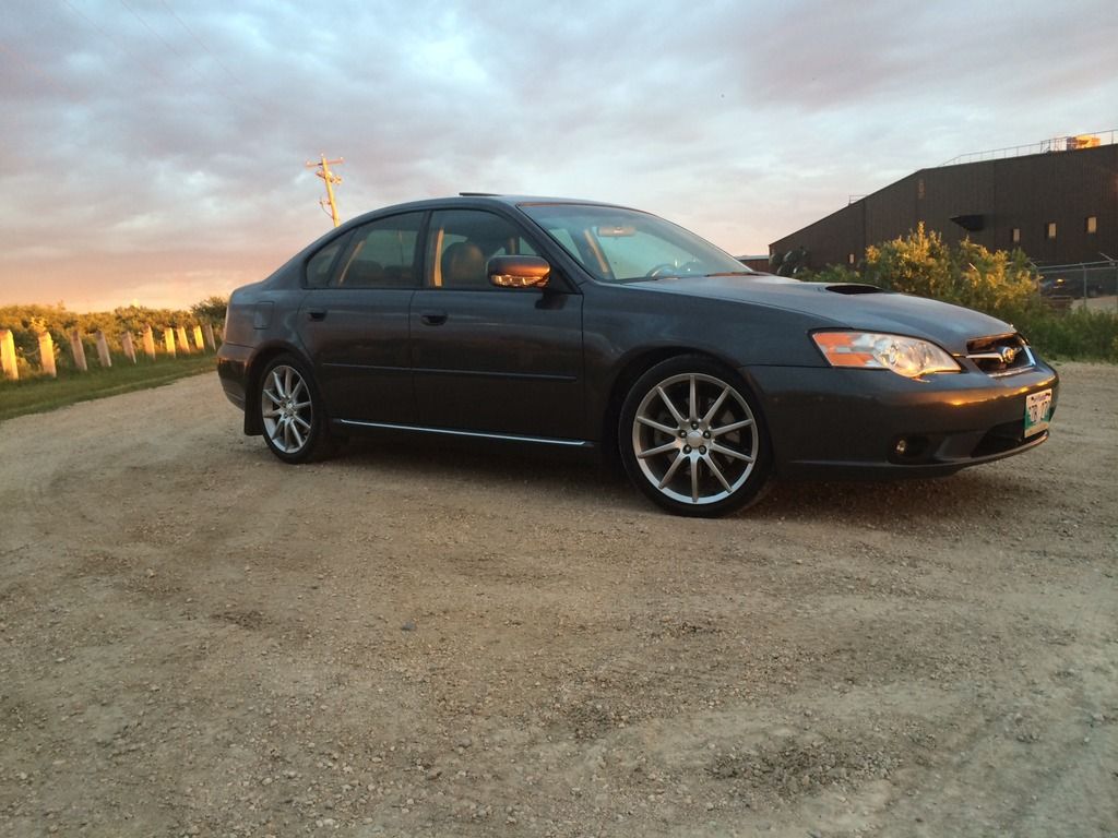

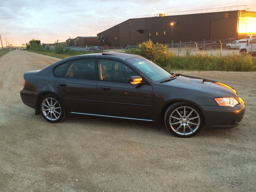

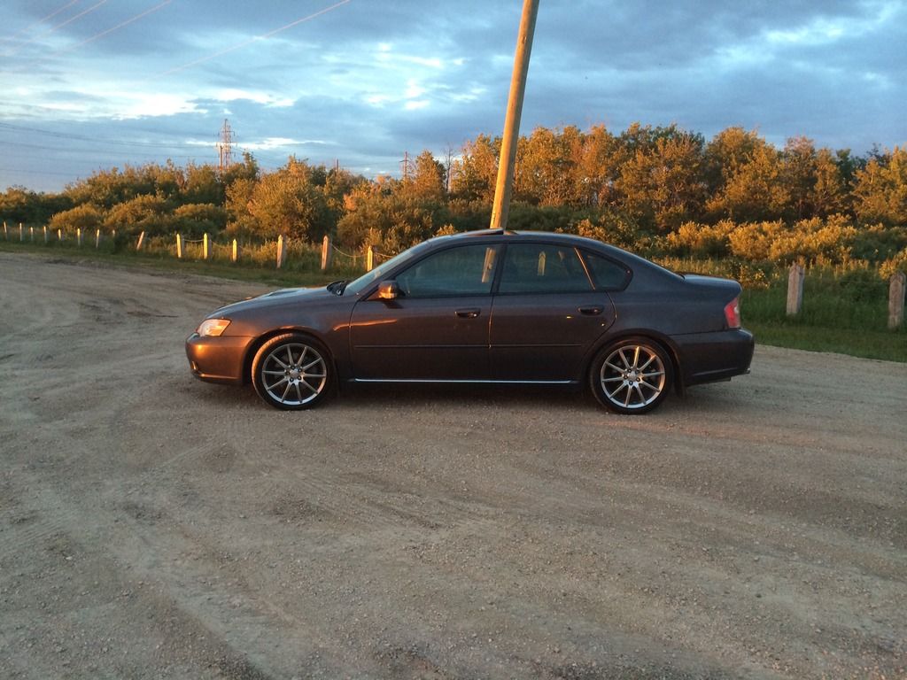

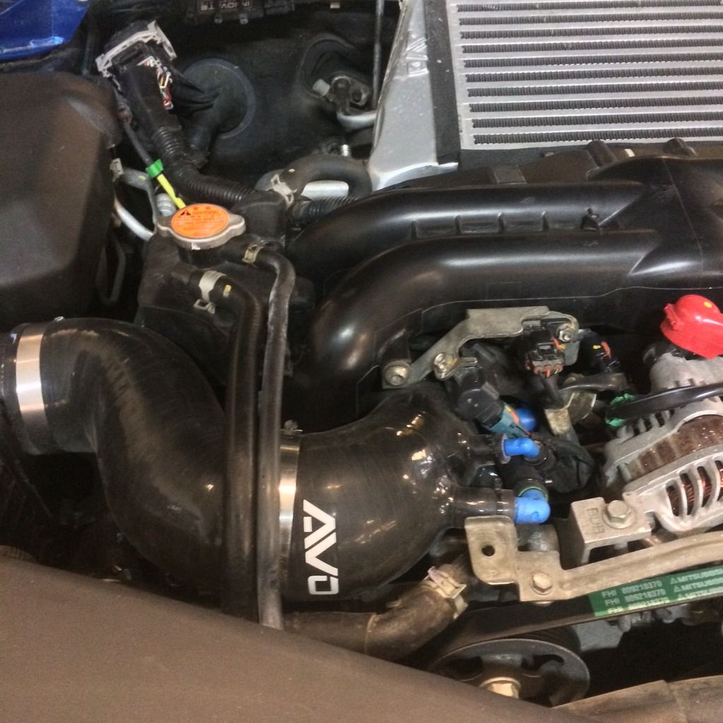

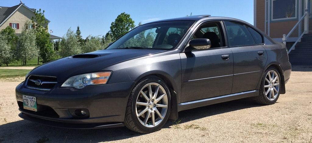

Hey Top Tier.

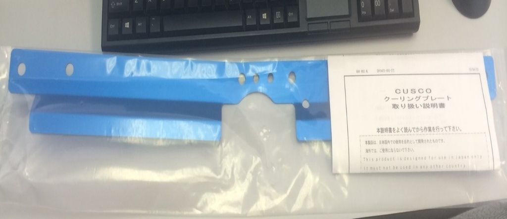

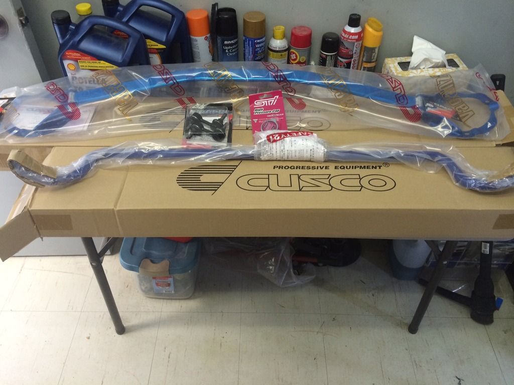

I picked this little beauty up about 1.5 years, the price was right and the mileage was low at 104,500kms so I couldn't pass it up. I've always been a fan of the Legacy and also have a white BD that I've owned for the last 11 years which was boosted and had meth injection(was returned to stock and now sold). The previous owner babied this car and the only performance mods he did were a stage1 flash, Invidia catback, rotor/pads/stainless lines and a COBB BPV. It didn't take long before I started ordering parts I was satisfied with the power and how the car handles but got used to it rather quick. I've got a few more things to add power wise then I'll be switching my focus and adding some cosmetic parts to the exterior and engine bay. Stay tuned for updates  :banana:
Engine:
COBB LWCP
Bren Tuning Stage 3 E-tune
Killer B Motorsport Oil Baffle Windage Tray
Killer B Motorsport pick up tube
STI 1.3bar Rad Cap
COBB AccessPort V2
JDM Battery & Power Steering Covers
Grimmpseed Master Cylinder Sock
Cusco Rad Shroud
Group A magnetic drain plug
Koyo radiator
Samco radiator hoses
Tomie timing belt guide
Intake/Exhaust/Fuel:
BNR EvoIII 16G
IAG braided oil feed line
COBB 725cc injectors

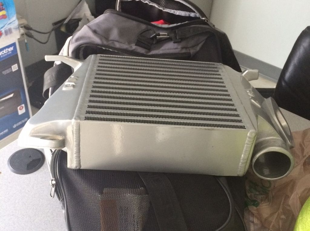

AVO TMIC

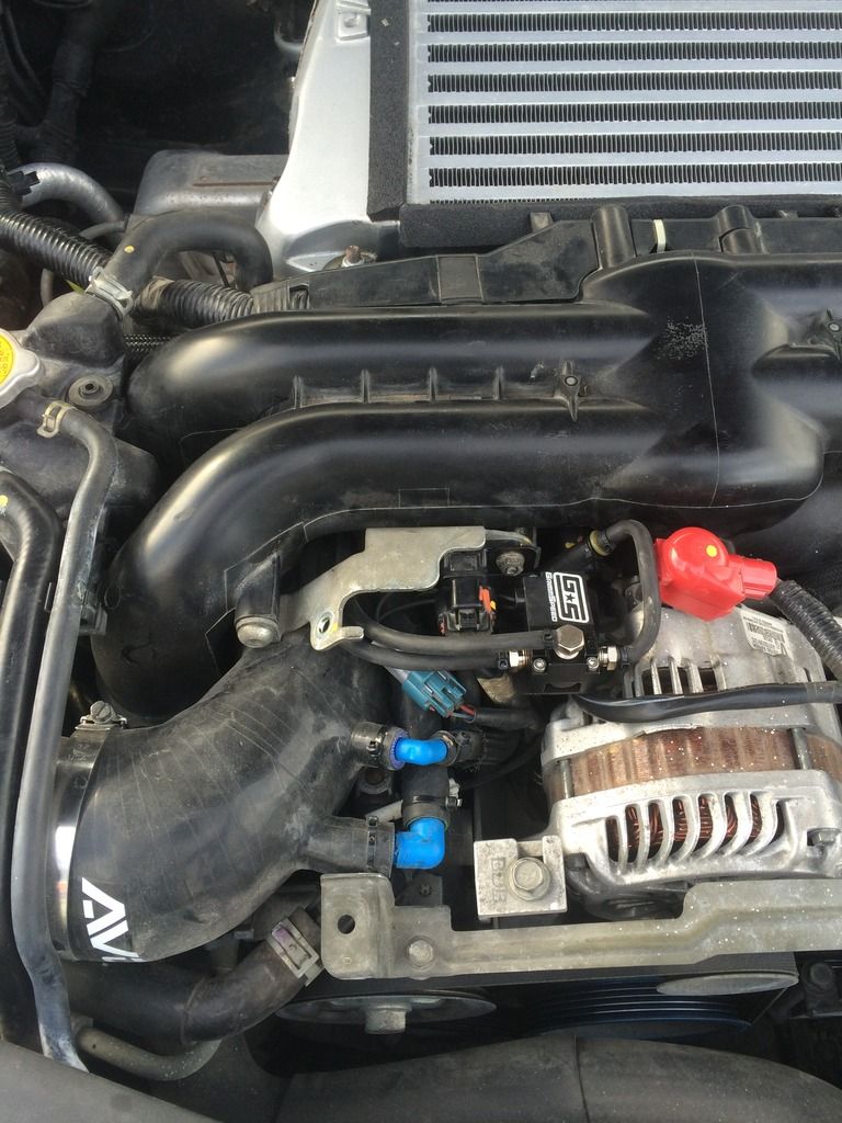

AVO Turbo Inlet

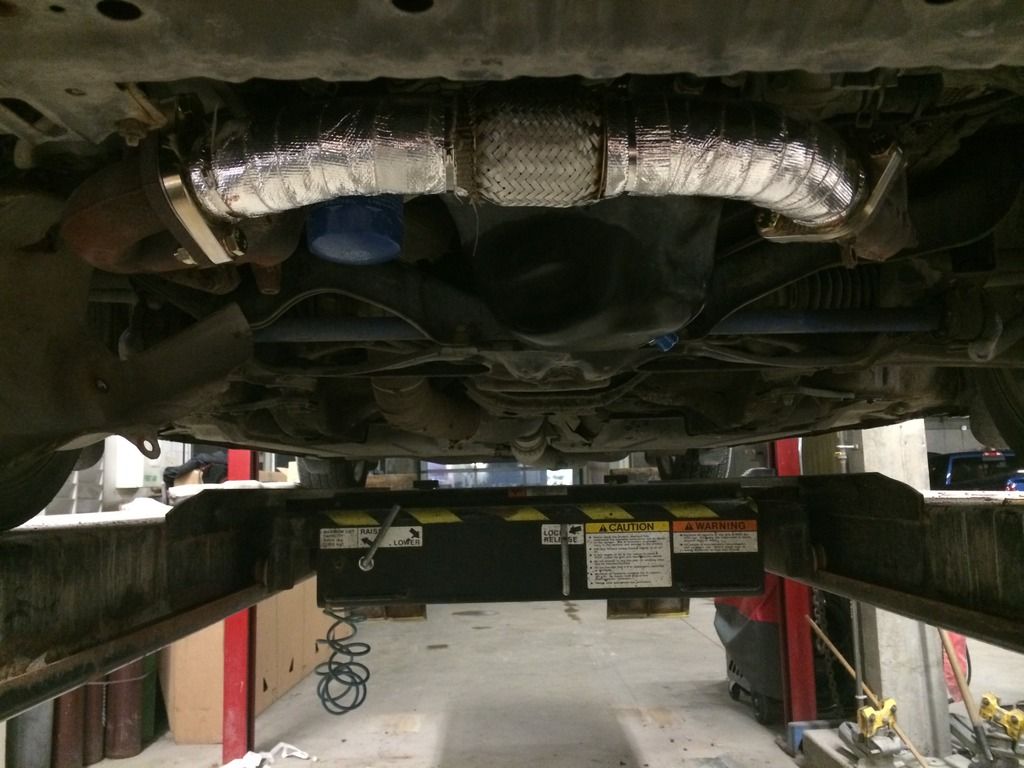

GrimmSpeed Downpipe
Grimmspeed crosspipe
Samco BPV hose
Grimmspeed CAI
STI port/polish exhaust manifolds
Invidia Q300 CatBack Exhaust
COBB BPV
PTP Turbo Blanket
Mishimoto Throttle Body Hose
DW 65C Pump
Grimmspeed EBC
Drivetrain/Transmission:
Kartboy Short Shifter
Kartboy Front Shifter Bushings
Group N Tranny Mount
Group N Pitch Stop Mount
Group N Motor mounts
Whiteline Gearbox Positive Shift Kit
Whiteline Rear Diff Positive kit
Whiteline Rear Differential Positive Power Front Kit
Suspension/Wheels:

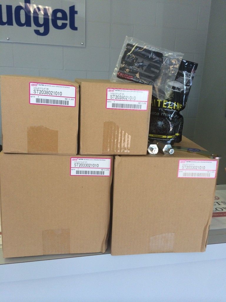

STI Pink Springs F-ST2033021010 R-ST2038021010
Whiteline 20mm Rear Sway Bar
Cusco 23mm Front Sway Bar
AVO RSB brackets
Cusco Front Endlinks
Cusco Front Strut Bar
Powerslot Rotors Front/Rear
Stoptech Pads Front/Rear
Goodridge Stainless Steel Break Lines Front/Rear
Wheels and Tires:
Summer -Stock Spec.B rims with Bridgestone Potenza RE-71R 225/40/18
Winter - Sport Edition rims with General Altimax 215/45/17
Interior/Electronics:
32% Tint
Innovate Motorsports LC-1
Innovate Motorsports MTX-D Boost Gauge
Exterior:
Launsport JDM pink rear badge
RRev Carbon fiber grill
Rally Armor mud flaps
BAysonR front lip
Awaiting install:
Redline hood struts
2017 Plans:
RRev carbon hood scoop
IAG AOS
Coolinmist meth injection kit

              I see youve done the cusco strut tower bar... how do you like it, notice any diference? and is that the whiteline rear sway bar? if so, same question

                    The turn in felt a little sharper with the addition of the strut tower bar, it fit well and adds a little bling under the hood. The rear sway bar is an adjustable 20mm Whiteline RSB. The difference I felt from this upgrade was night and day. The factor bar was 15mm and felt like it would understeer a lot, with the new bar installed it made the car feel more neutral.

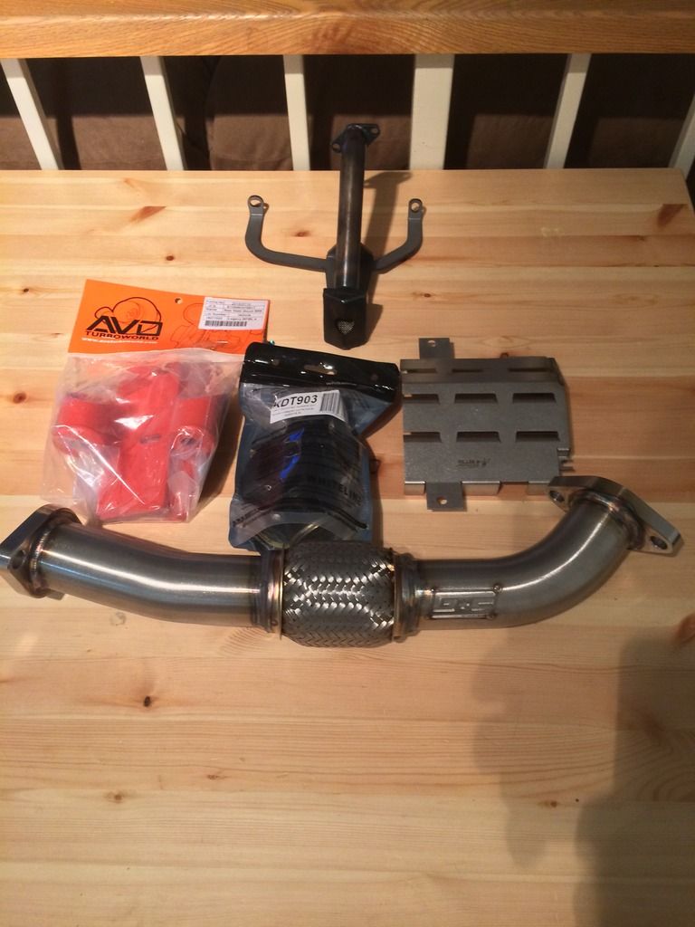

                              How'd you get the Grimmspeed Downpipe to work with the VF46?
                                March 18, 2016, 10:01 AM #16
                                4U2Envy Offline
                                • Posts: 98
                                • Vehicle: 2007 Subaru Legacy Spec.B
                                • 4U2Envy has no influence.
                                Hey Sahba. The GS downpipe I ordered was a direct bolt on affair, it's made for the 08+ WRX/STI and 05+ LGT style turbos.
                                https://www.rallysportdirect.com/fits/2007-subaru-legacy-gt-spec-b-2-5/downpipes-and-y-pipes/grm-007088-grimmspeed-downpipe-divorced

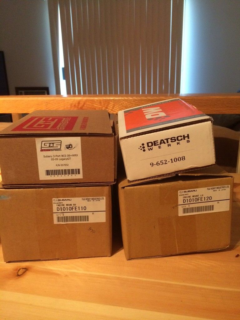

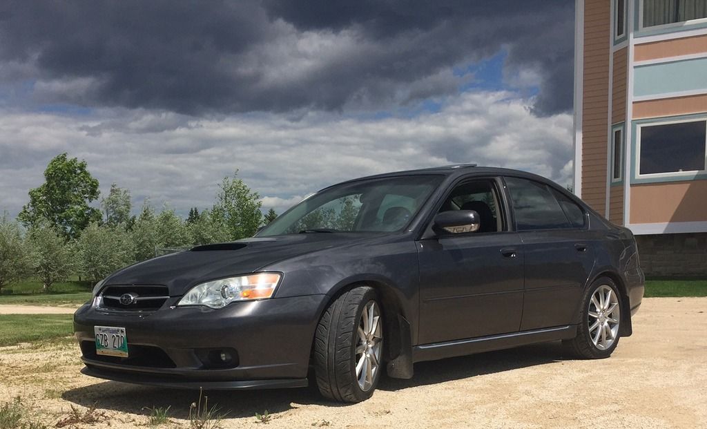

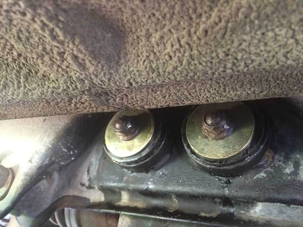

                                  Finally installed my Group N motor mounts and Killer B pick up and baffle :banana: I installed this lip a few weeks ago, really liking how it looks now.

                                    Nice, that adds a bit more aggressiveness to the front. How do the new engine mounts feel? I've been considering doing this to my subie, it makes tons of sense on fwd cars for the torque spin on the motor, but how does it affect the awd?

                                      stock pieces on subarus are gummy worms, Upgrading them makes your drivetrain more in place, and more predictable. if that makes sense.

                                        What was wrong with the stock motor mounts?
                                        Nothing was wrong with the factory mount but I've been wanting to upgrade them for a while now. I had the Group N tranny and pitch mount already installed and this was the final mod to take take the excess slack out of the drivetrain.
                                        The new mounts feel great, everything feels much more connected now. We have a lot of motor movement from side to side and these eliminate that. I love the way these mounts feel, if your on the fence about these hit me up and we can go for a spin.

                                            Do the mounts add noticeable NVH?
                                              April 26, 2016, 07:40 AM #24
                                              4U2Envy Offline
                                              • Posts: 98
                                              Not much at all besides a slight vibration at idle. I picked up the gf saturday afternoon after installing these and she didn't notice anything out of the ordinary.
