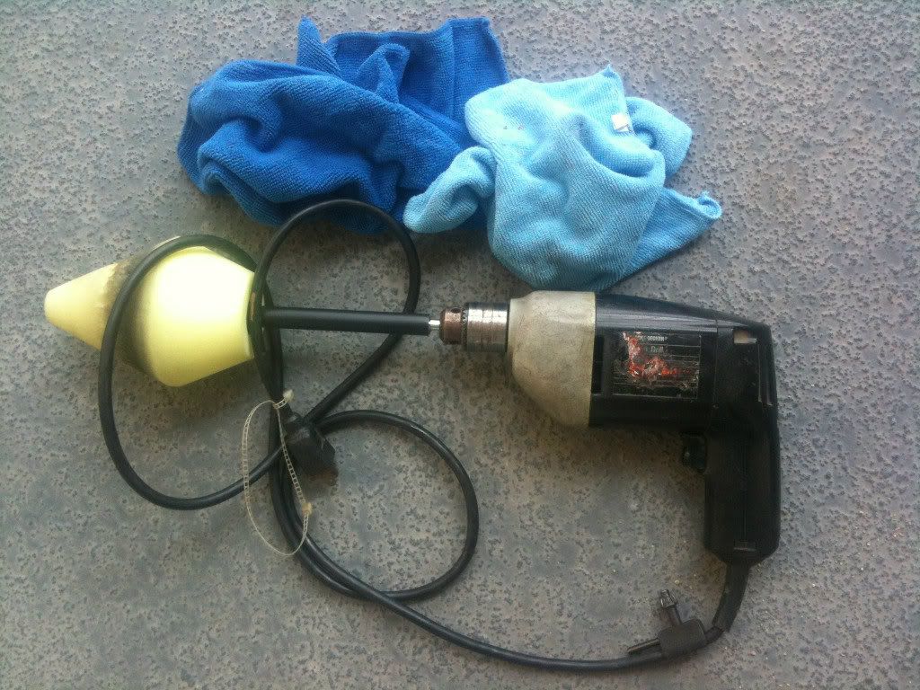

MATERIALS I'LL BE USING:
- 1200rpm corded drill (prefer this as its a constant power source and not likely to die on you)
- 220grit autobody sandpaper
- 500grit autobody sandpaper
- 1500grit wet/ dry autobody sandpaper
- coarse, medium and fine steel wool
- 2 microfiber cloths (1 to wipe away sanding dust and 1 to wipe away excess polish residue)
- Meguiars all-metal polish compound (you can use any metal polishing compound you like)
- Meguiars metal rim polisher cone attachment (you can use any type of polisher attachment you like)
- Mechanics gloves (you will be using the steel wool at some point)
- Respirator of some sort (you will be sanding and it does kick up dust, especially the steel wool)
http://i1270.photobucket.com/albums/jj619/slidewayzbentley/IMG_2587.jpg[/img]]

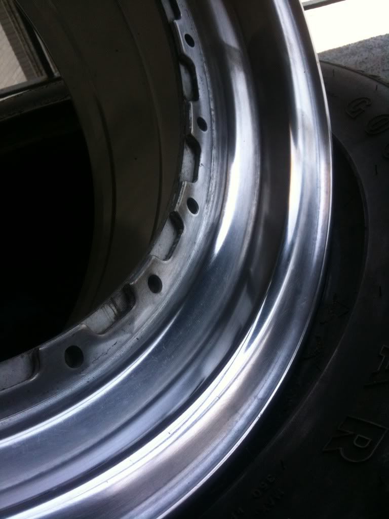

- Continue polishing the rim till your happy with the final product. Heres a comparison of one finished rim to the old rim and some close ups of a finished one:
http://i1270.photobucket.com/albums/jj619/slidewayzbentley/IMG_2596.jpg[/img]]
http://i1270.photobucket.com/albums/jj619/slidewayzbentley/IMG_2593.jpg[/img]]
http://i1270.photobucket.com/albums/jj619/slidewayzbentley/IMG_2594.jpg[/img]]
And thats it for this how-to guide. I hope you've found it useful for your current or future applicaiton.
