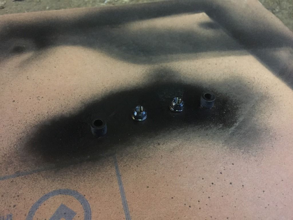

If you punch bolts through the cardboard you can paint the heads evenly without getting paint on the threads. Saves you having to run a die over them all afterwards and you don't have to spray them twice to get both sides. You can setup nuts on spare bolts or threaded rod for the same reason (protecting the threads).

    Spray paint is actually thin enough it doesn't mess with the threads.  Kinda acts as a gentle thread locker really.  The bolts turn in and out by hand no problem.  It more so takes up any slack in the threads. I paint them for that reason.  Call it my own anti-vibration rattle out of place insurance...
    Powder coat on the other hand is detrimental to your bolts.  That requires a tap or die.

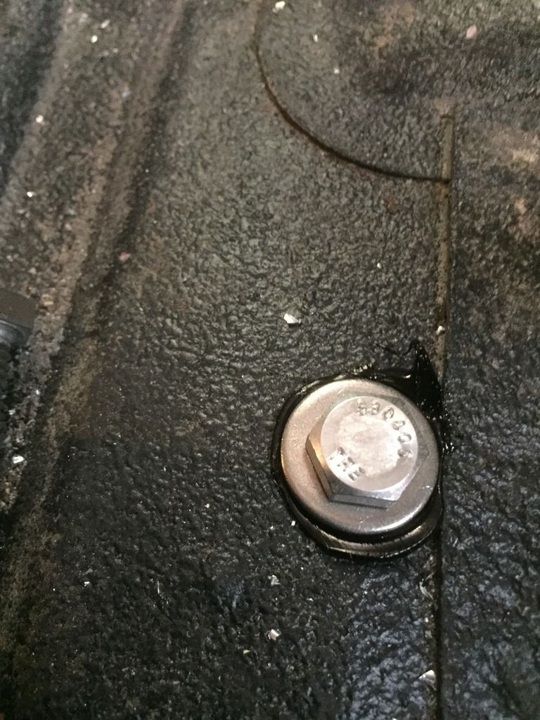

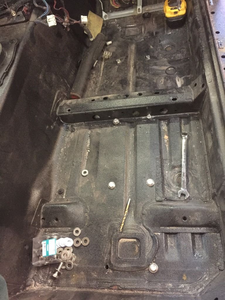

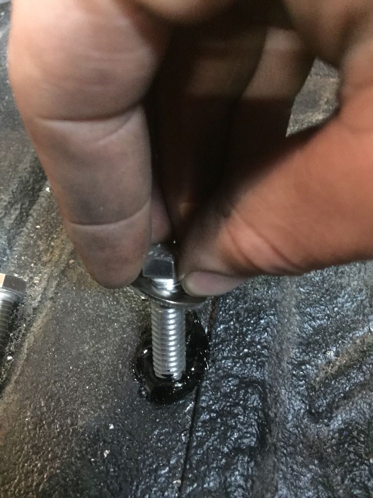

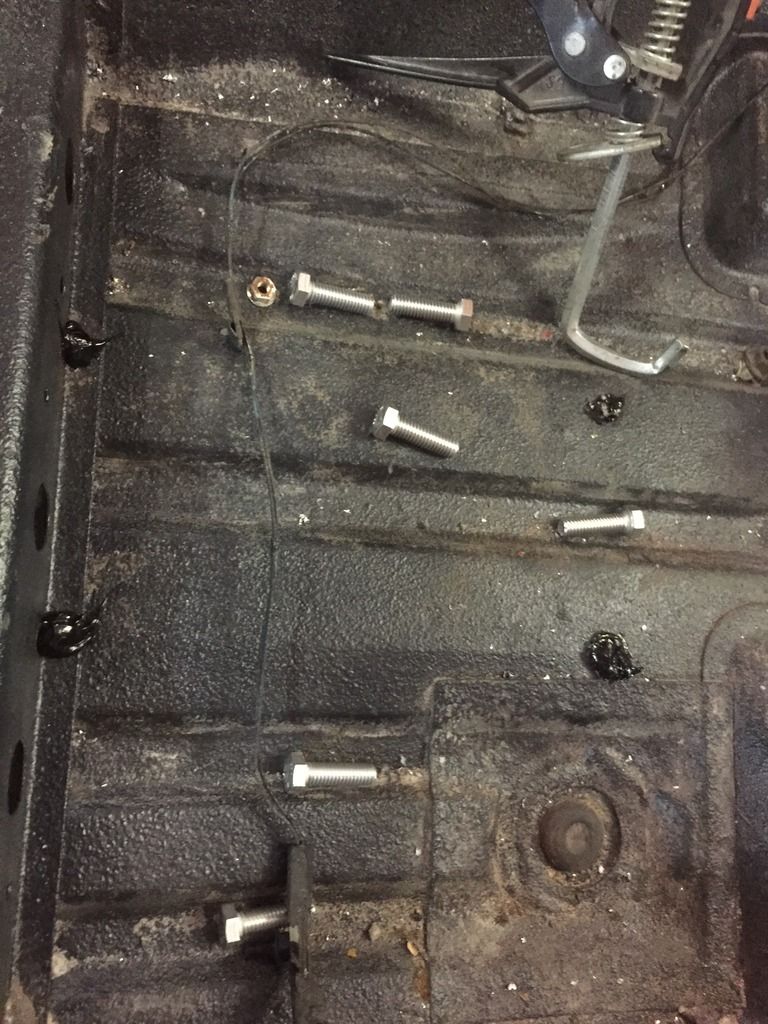

                    I can't stress this enough to anyone who wants to do a project this big.. double tripple and quadrouple check EVERY bolt on the car before you go anywhere.  Every time I slide under the car I just take a look to see if I missed anything.  Sure enough... I tightened the axle on one side but not the other. (note driveline is temporary and that's why I've left it ugly and dirty.  Upgrades are planned!)

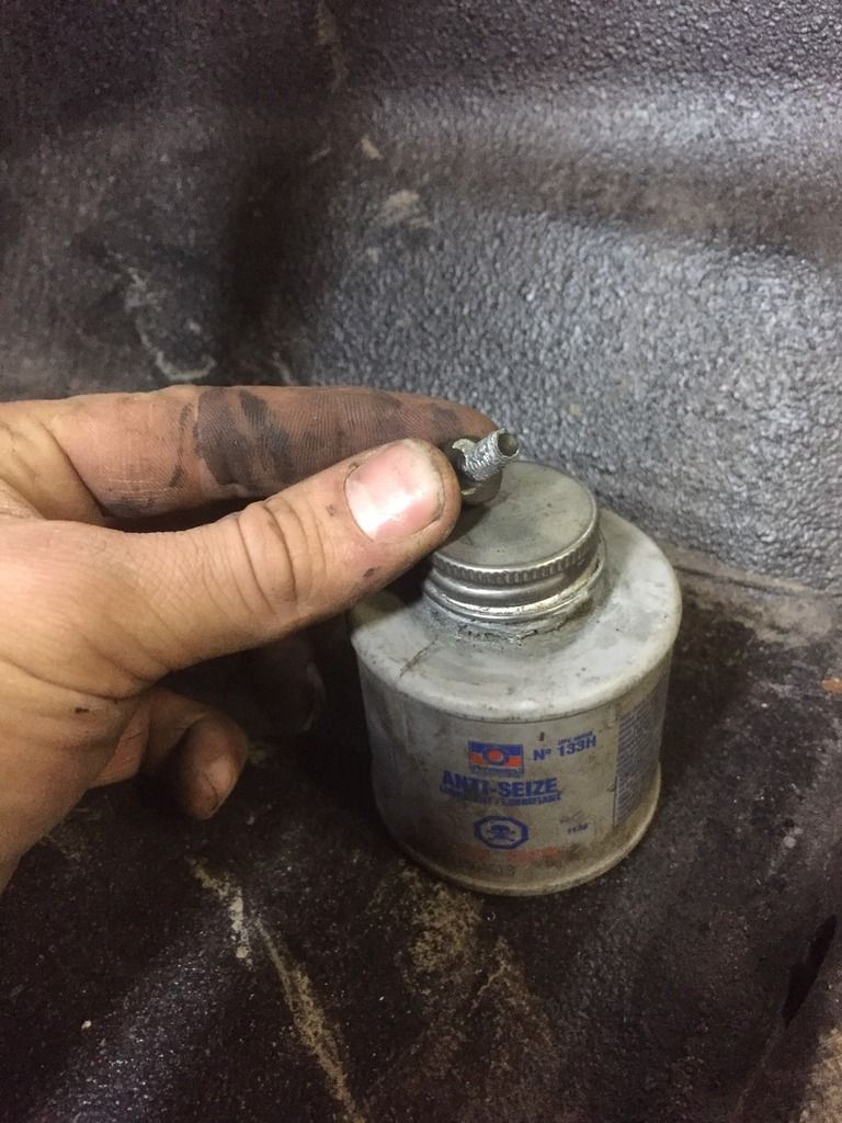

                    This whole project is a tedious bit as EVERY bolt gets painted with anti-seize.  Takes a whole bunch of extra time.  But at least my bolts won't ever rust.
                    This is probably the most annoying part of the whole build.  I need these specialized bolts and spacers for this or that and I've done too much work to just "leave them rusty cause you don't see them" so they get blasted and painted.  Just to keep my brain at ease so I can sleep at night knowing I don't have any rusty nuts...
                    The other thing I'd like to stress for anyone looking to take on a big build like this.  If you're going to drill holes in your car, PLEASE SEAL THE HOLES!  all your work is just going to go down the tubes if you don't seal your fresh metal!  Left over windshield urethane goes into each hole to seal it off from the out door elements.  Caution though... urethane is the stickiest and dirtiest substance in the known world.
                    Frame Rail supports getting bolted in.

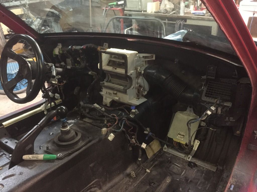

                      26 years of dust build up, it was time for a good ol cleaning behind the dash.
                      Forgot the carpet outside in the snow, so I had to force dry it. It goes in before the dash.

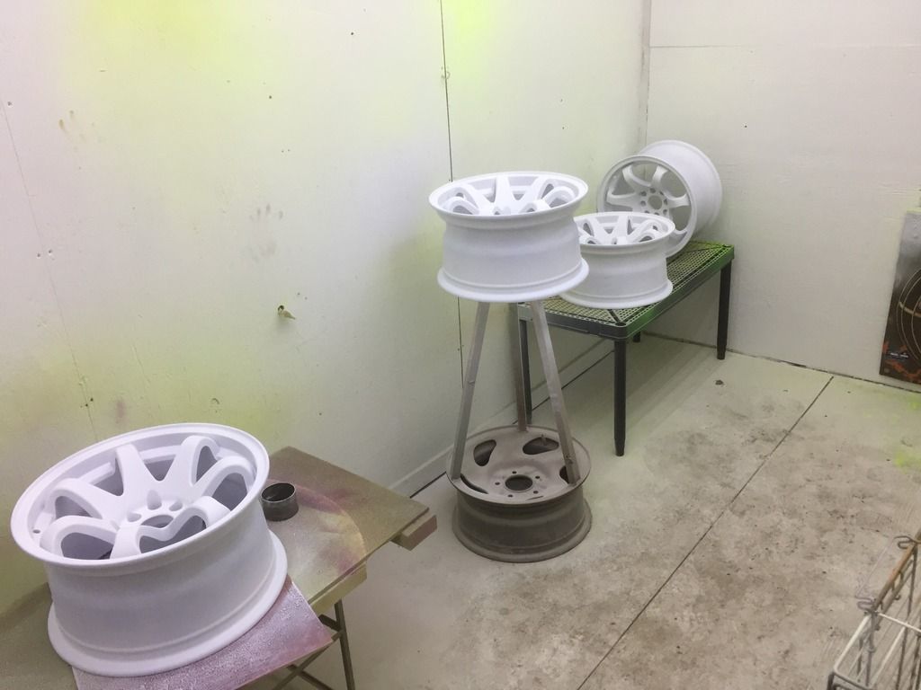

                                Rims painted
                                Rims dipped
