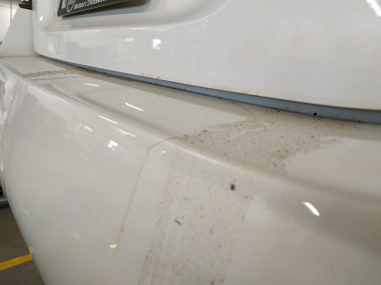

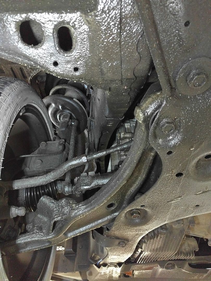

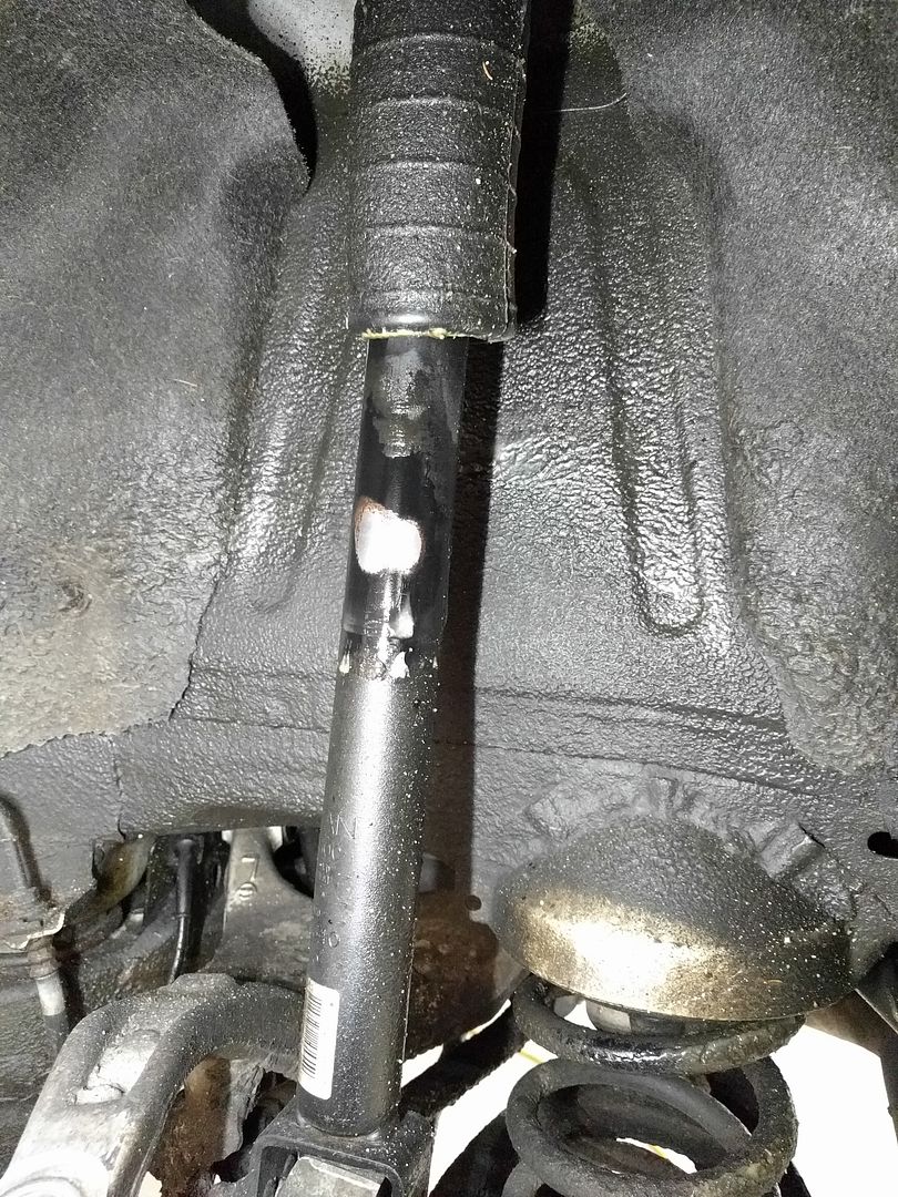

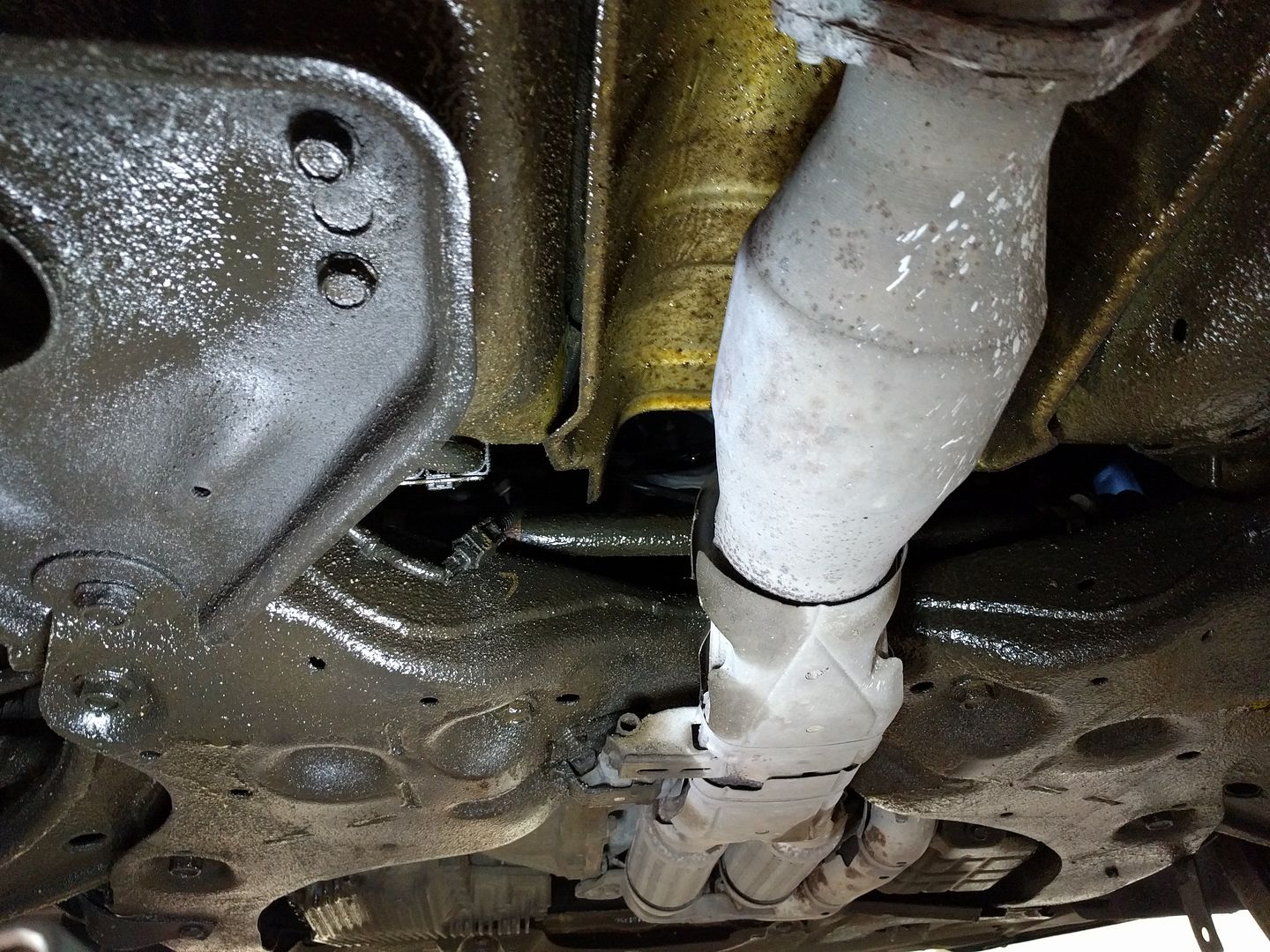

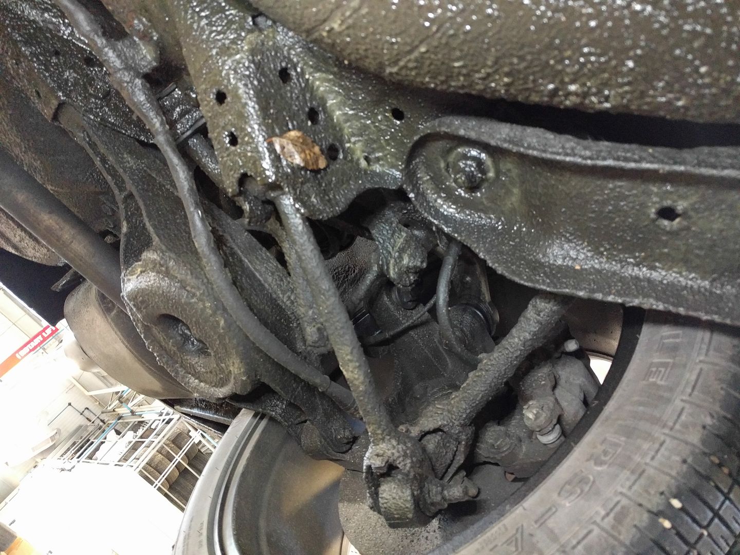

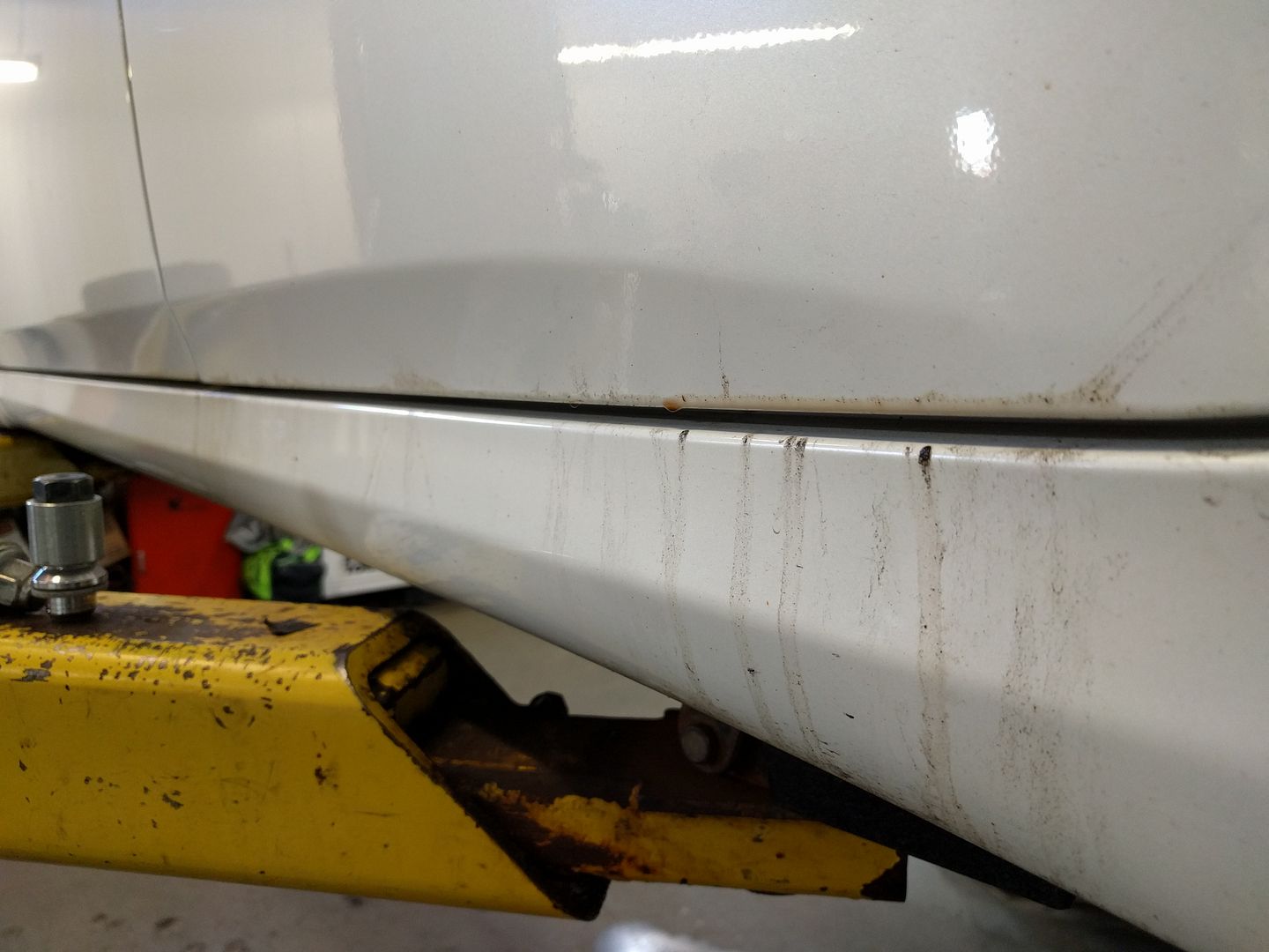

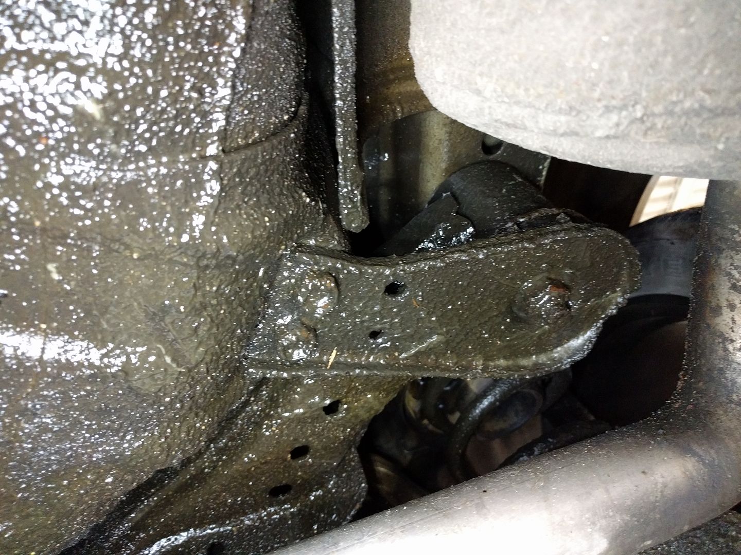

                                          Pictures from what a Rust Check'd vehicle looks like:
                                          Makes all the shocks look blown.
                                          Also messes with all the rubber components (bushings, spring seats, etc). Soaking rubber stuff in oil makes them swell. I've seen a bunch of ruined weatherstripping along the bottom of doors that swell and get all wavy.
                                          Of course it also collects at the bottom of the doors and hood/trunk. You can see the drips here, the oil is sort of orange in colour.
                                          So does it protect from rust? Absolutely, really well. But it makes an awful mess of the car. Really sucks to work on, would you want to change a control arm on that car?

                                            What a mess.
                                            Good for someone who has all their work done at a shop, and doesn't work on it themselves :lol:
