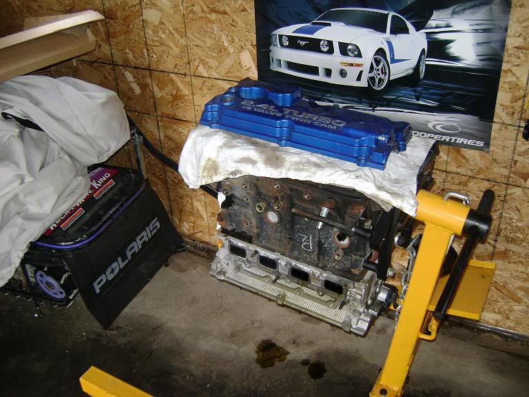

On the PL Neon platform, when working without a hoist it is easiest to yank the transmission and engine as an assembly out the top. So that's exactly what I did. I eventually got the thought of rebuilding the engine, for whatever reason. So, I started disassembly.

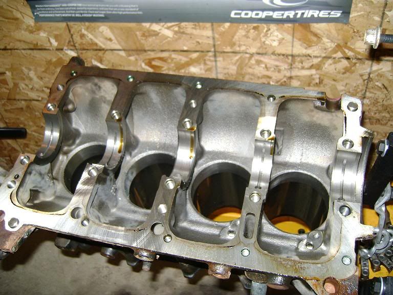

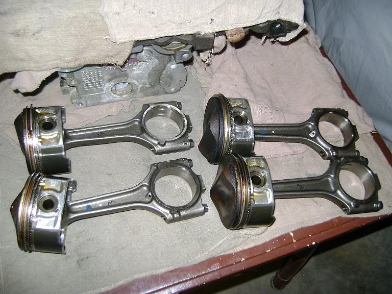

The internals of the block and cylinder head were in fantastically mint condition (to this day the car only has 38k on it), which I was quite happy to see, although not surprised. These engines have all forged internals and quite simply are close to bulletproof.
The pistons and cracked-cap connecting rods now reside in a friends 2.4L swapped 1st gen Neon, making it essentially a built motor.

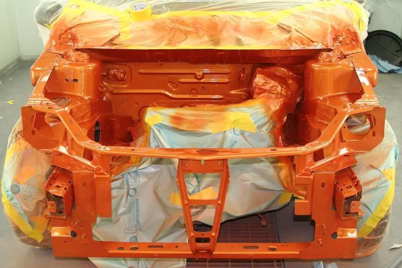

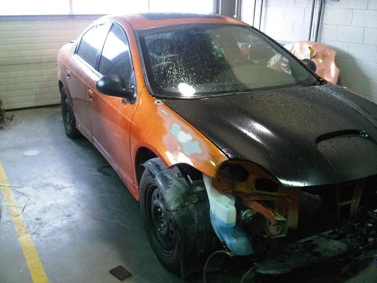

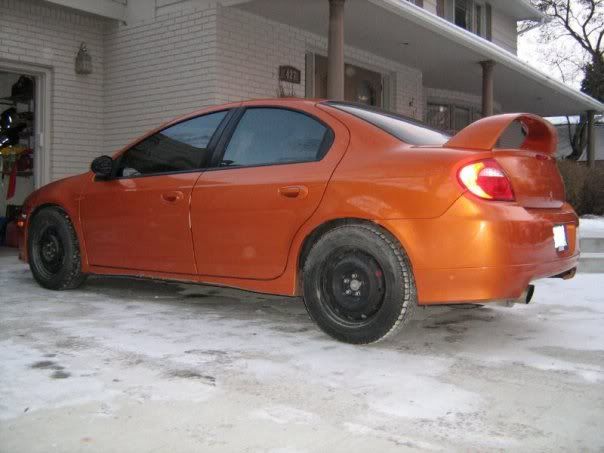

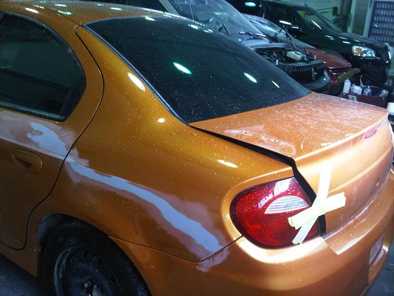

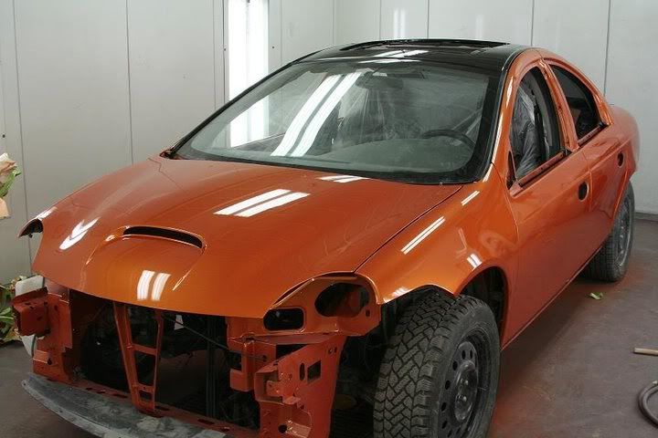

Since the car had a small vandalism claim and a small stone chip claim, off it went to the bodyshop, where I eventually decided to repaint the entire car, and paint the roof gloss black. The car recieved a new OEM hood, bumper, headlights, and tons of other little odds and ends. The antenna and rear trunk lock were also shaved.

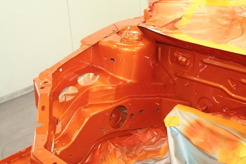

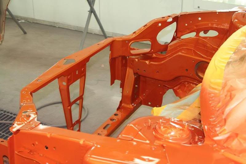

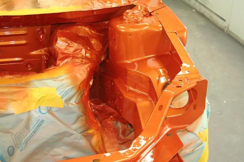

Devon Dorosh performed all the bodywork, and convinced me to strip the bay and paint that as well. The color is a custom offshoot of the factory PVK Orange Blast code, it is simply amazing in person and shines a million times better then stock. I couldnt have asked for a better job.
The final result was this:

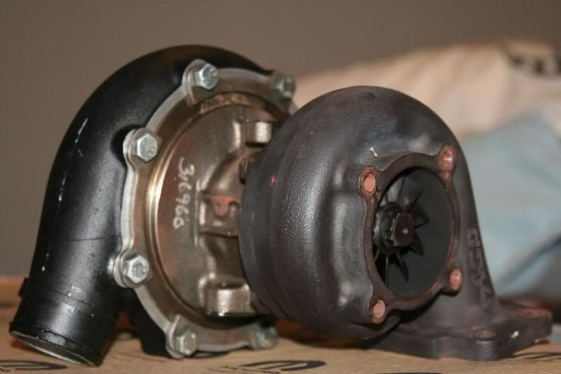

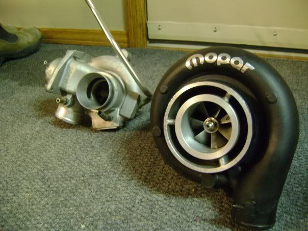

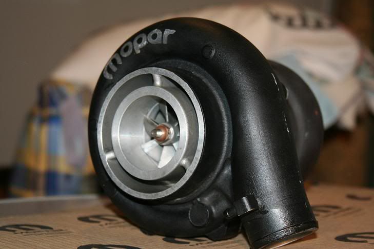

Also while it was in the bodyshop, I decided to go big turbo and picked up this awesome piece:
Stock turbo is on the left.
It was an AGP BorgWarner S256 .63, powdercoated to look Mopar, and wow did it ever troll a lot of people while it sat on my shelf. It has since been sold, my plans have probably changed 1000 times since I started disassembling the car.

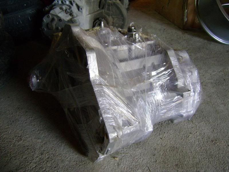

A fully race prepped transaxle assembly built by the one and only Ed Peters, a key player in the factory Neon racing teams and essentially the man who knows everything about making a Neon go faster/handle better/brake harder. New Venture Gear cast this trans, its custom 1 inch thick/21 spline input shaft, and its custom 3.77 final drive specifically for him, to go into an SRT4 World Challenge car. He then went to work on it, porting, camfering, and comet trailing anything that had to do with the oiling system. The shift forks have been lightened, all casting flash has been removed, etc etc. It would take an entire page to describe what has been done to this trans. Only 4 of them exist. Only one of them is actually in a car, the owner of Modernperformance.com's personal SRT4. Not sure about the other two, they have probably been destroyed in the name of asset reduction.

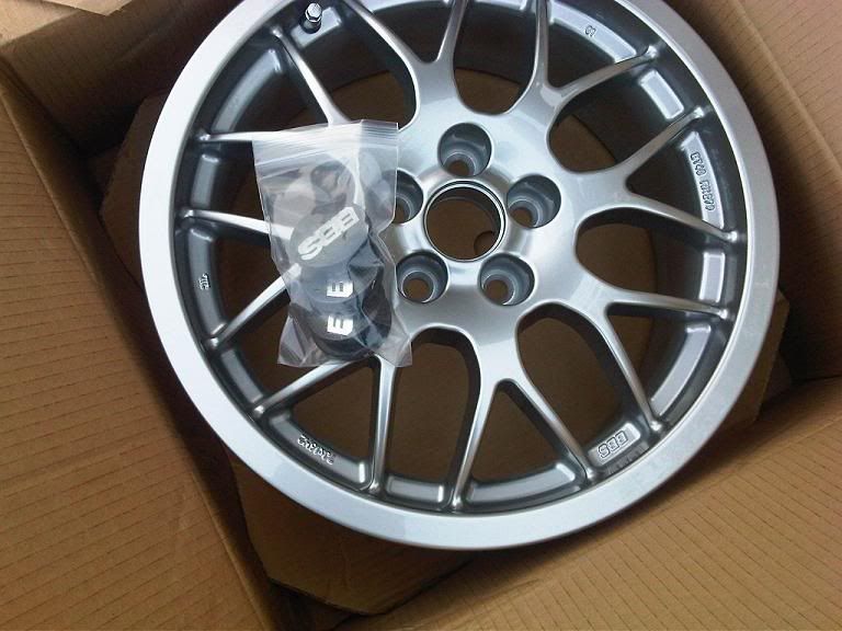

Also sourced these from Ed as well, the last known set of factory new BBS RX wheels from an ACR SRT4, still in their BBS boxes. I have only opened one, so for all I know, the other 3 could be steelies lol.
Poor guy works too hard!

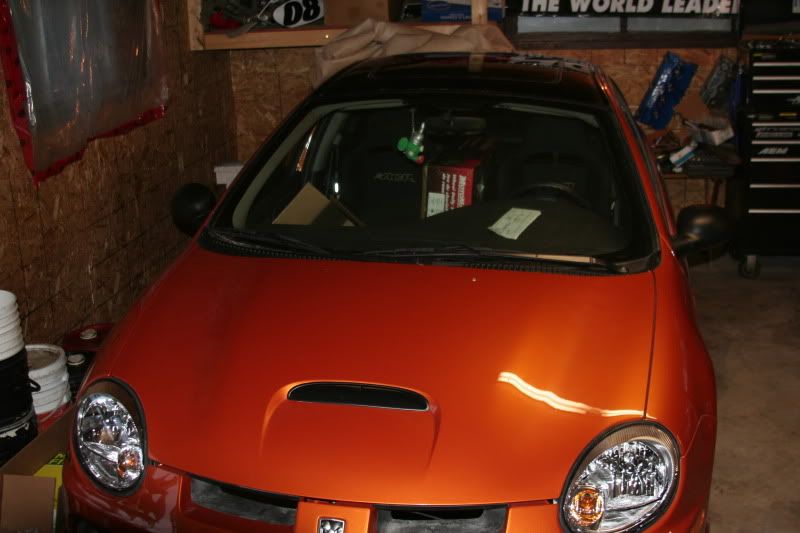

The cover is an indoor only Dustop one from Autopia/Covercraft. It was a bit pricey but worth every penny. It is custom cut and fits the car perfectly. There is even extra material cut for the tall spoiler, which is great considering I thought they would just send me one for a normal Neon. I am impressed to say the least.

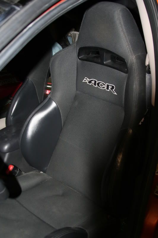

The SRT4 ACR seats were a gift from the girlfriend. Greatest factory seats in any compact car. /opinion

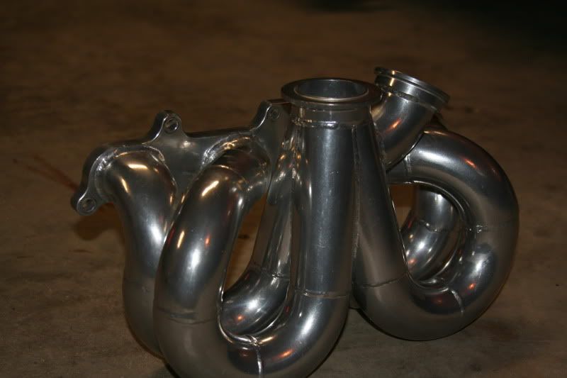

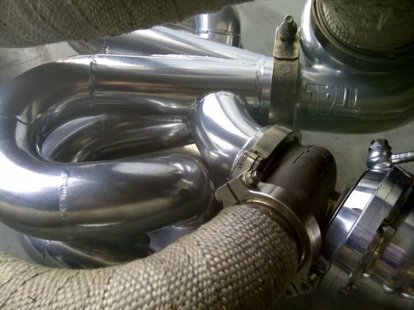

The exhaust manifold is a custom built stainless piece, all vband connections.
Wastegate is a 44mm TiAL V44.

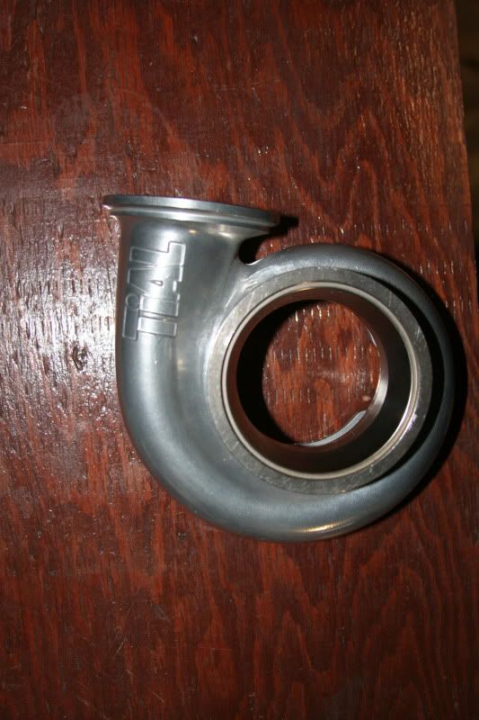

The turbine housing is a TiAL GT35 cast stainless steel 0.82 A/R.

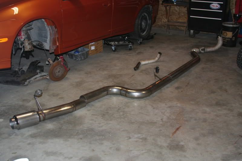

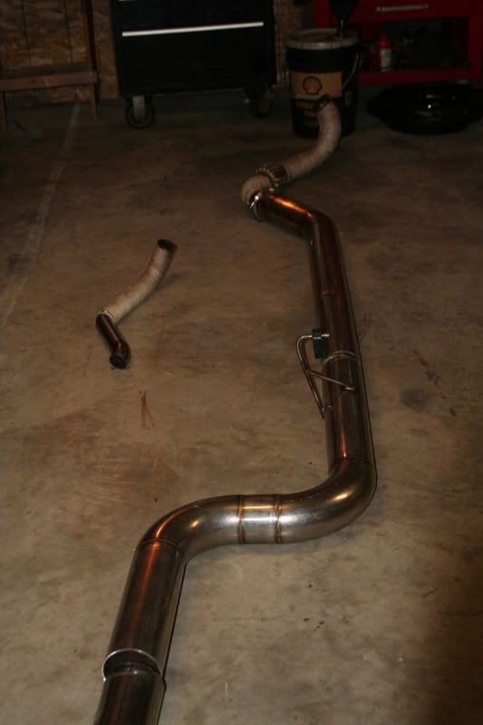

The exhaust is a full stainless 4" turboback with a Burns stainless muffler. That will be getting chopped and replaced with more 4" pipe.
The piece on the left is the wastegate dump tube, which itself is larger then the stock exhaust on our F150.
Everything Vband.

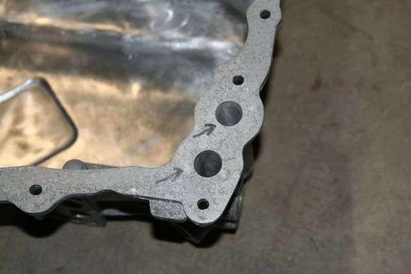

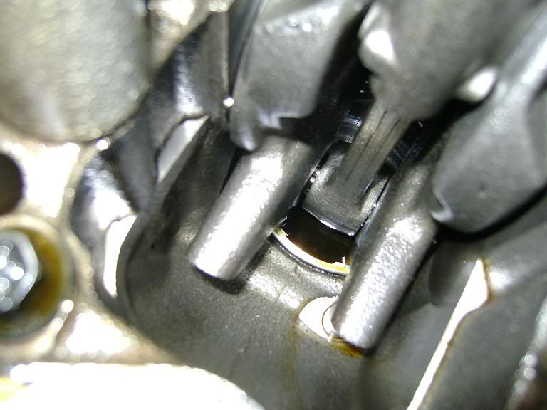

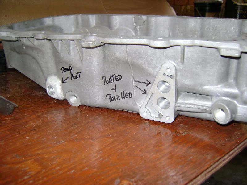

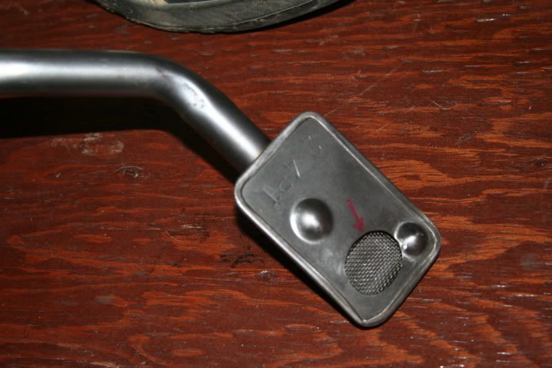

The oil pan has had all its casting flash removed, so no small bits break off and then circulate through the oiling system. An oil temperature bung has been added. Its passages have also been ported and polished, again by our good friend Ed.
The pickup tube orifice has been enlarged considerably.

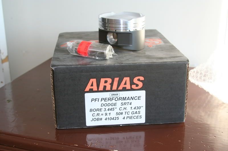

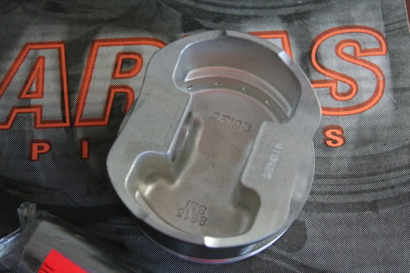

The pistons are custom, 9:1 compression PFI spec Arias units, that have a ceramic thermal barrier coating on the tops, and a dry film lubricant on the skirts. The coating was done by Calico. I got the HD tool steel wrist pins with them as well.
I have two sets of piston rings. The supplied Arias steel ones, and gapless Total Seal ones. The Arias rings will be used.

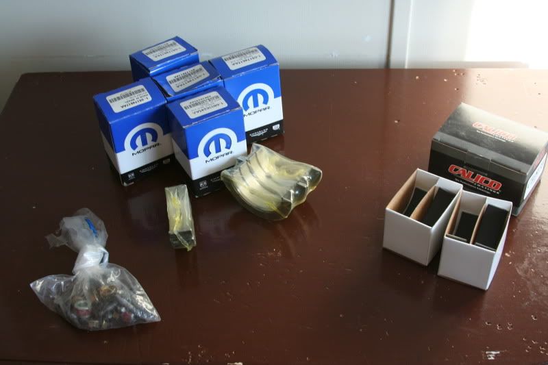

From left to right, oil pan studs, Mopar main bearings and thrust bearing, and Clevite CB-1813H connecting rod bearings, also dry film coated by Calico.
