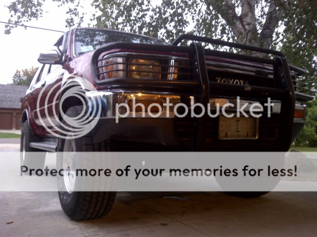

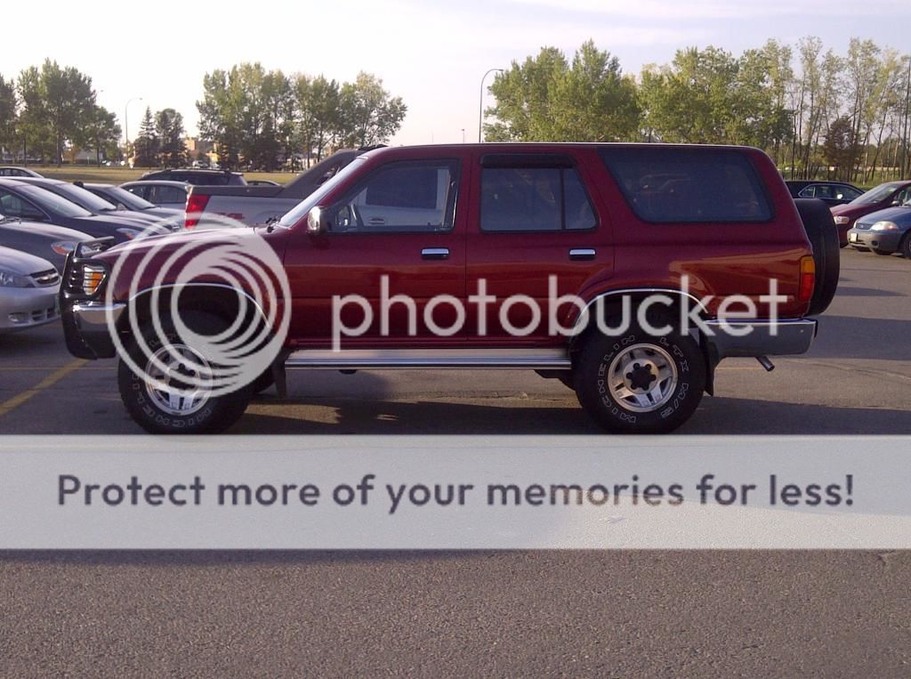

                I have a 1990 Toyota 4Runner. Has the 3.slow v6 in it.
                4wd doesnt work in it because of the stupid air operated system, so i'm going to bypass that crap.
                Here it is
                Plans for it are as follows. (Have them all ready to go, just waiting for a few dys off work for the install)
                6 inch lift, 33 inch studded general tire grabber at2's, full poly bushing kit, locking rear diff, still trying to decide which route to go with this, maybe just a limited slip to maintain the street driveability.
                Future plans, front locker/lsd and possibly new gearing and 35's

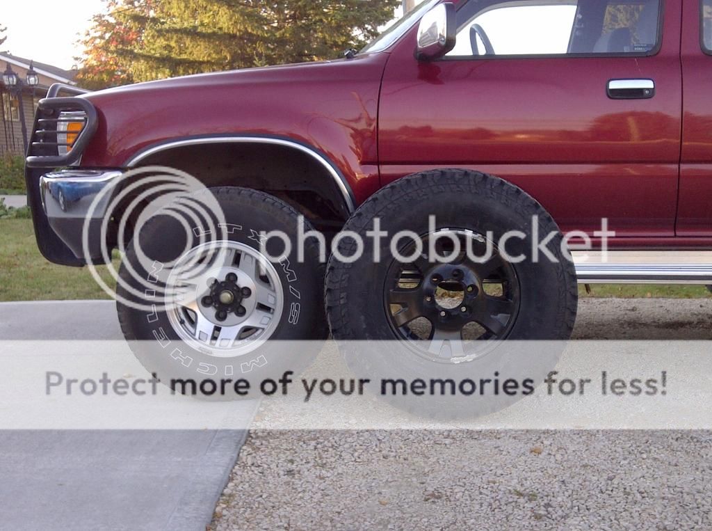

                Here's the tires compared to the stock 31's
                Looking forward to getting this beast built and bombing around in it

                  Are you planning to bypass the air operating system, so that the 4x4 will work?

                    Not sure if sarcastic? haha, yes thats what i said :p
                    Basically i have to open up the diff and manually position the fork so that its on the gear, and hold it there with whatever, worm gear clamp or something so that it won't move.
                    That way the diff will always spin, and then i still maintain on the fly shifting inside the cabin by using the lever to manually engage the transfer case. I dont really care if the light on the dash works or not.

                      Those tires are gonna be awesome, looks like there was some trouble balancing them though?

                        Yeah bummed me out when i saw they used those weights and not the ones on the inside of the rims, im gunna need to paint them again now. but yeah it does seem like it took quite a bit to get them balanced.
