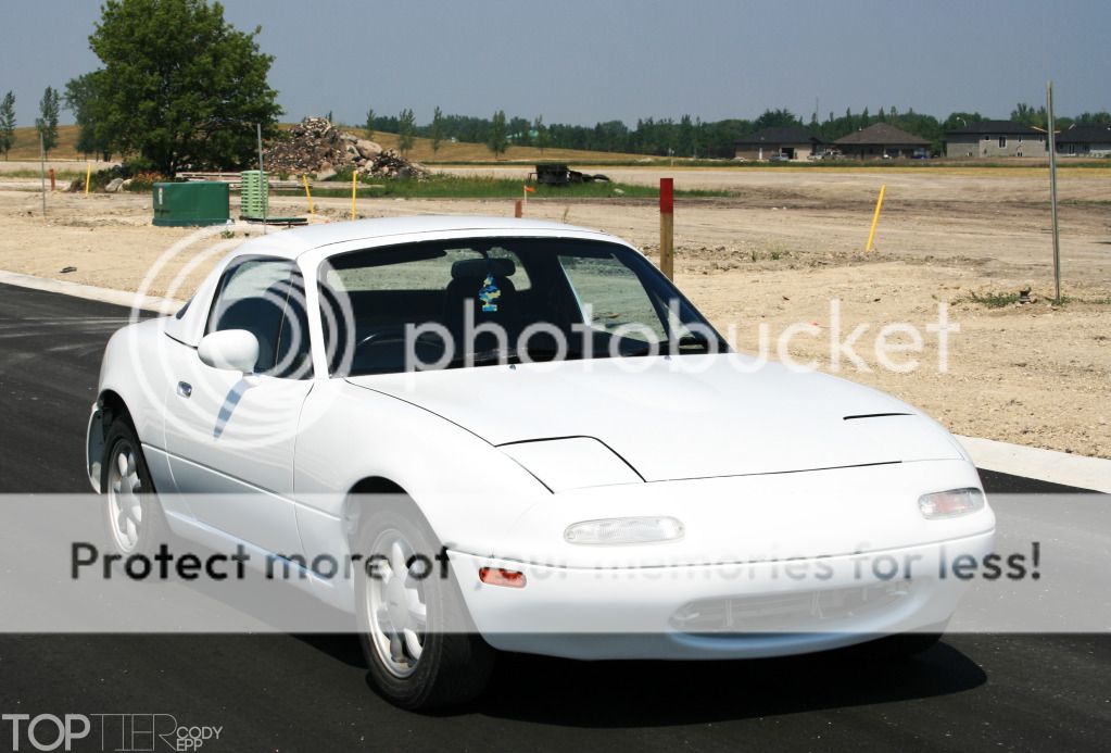

Pretty much it's the same write up as what my ad is just with pictures at the right places and maybe some further details about what I all did. So... it's a forsale ad but you can really format THIS into kijiji.  Enjoy my friends
I bought this as a project car to restore and now that I'm complete, I'd like to sell it. (I have too many cars to keep this one)
So down to brass taxes:

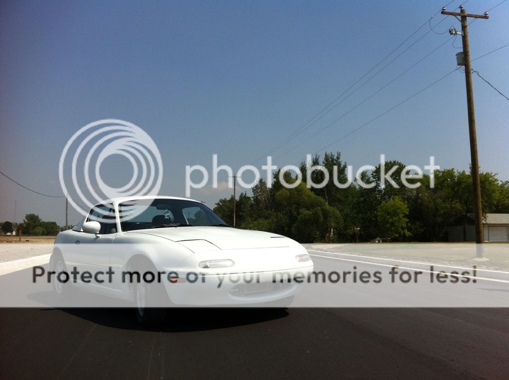

1990 Mazda Eunos Roadster (right hand drive miata) at first sight
and one fancy wide angle iphone made shot
I bought it with a 1.8l engine swapped in because the original owner didn't replace the coolant so the block cracked I assume on that engine. Thus, WTC swapped in the 1.8l engine.  I've since found the guys who did the swap and they informed me about the details of the swap and how it went.  (they didn't have any bad news)
The unknown benefit (to most) of having a 1.8L engine in the 1.6L body, is that the wheel base is actually shorter and a weee bit lighter. However I think the weight is mostly due to the engine size.  Auto X guys like to do this swap as it gives you a tiny bit of a better advantage in the corners as TECHNICALLY your car turns tighter.  It would never be worth the money to do the swap for that reason alone but if you have to replace the engine anyway... why not right?
I've thoroughly gone through the engine and tranny and I haven't seen anything of any concern.  I drove the car for 10,000km and honestly did not have a single issue. This is the first car I've ever owned where the work under the hood was just by my own free will and not fixing something that broke.  That being said, there's not much to tell about drivetrain.  Run's perfect. I ran premium in it just because Canadian fuel is so poor quality and bad for your engine I give my engines that extra love they deserve.  Be good to your car and it will be good to you.

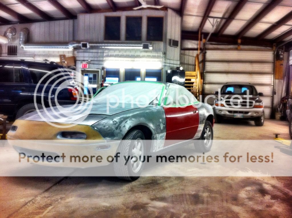

I bought the car with the paint falling off (there was a span of those, feel free to research as I don't want to explain that too)

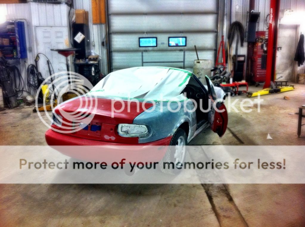

Having previously worked in an auto body shop as an apprentice, I took it on as a winter project.  It turned out to be WAAAAAYYY more work then I expected.
Started by taking that ugly spoiler off, and welding the holes shut, covering with fiberglassy kinda bondo, then bondo for the final finish. this pic is mid job to show the fiberglassing.  but i didn't even end up using this lid as I took the one of the parts car. then... there is less opportunity for paint faliure in the future. so this picture is actually totally irrelivent.
This was it's winter beater mode... kinda! didn't really stay the same color 2 week in a row.
lots of teaching happened from the big brother
There was a lot more bondo on the fenders then I was expecting too. So once I knew what I was all in for, I went out and bought a parts miata that had 70,000km on it and was in beautiful condition except for the entire front end being smashed up.
First thing to be swapped was the hard top
I took, the doors + door panels, trunk, rear bumper, license plate bezel thing, and the hard top.  That cut down on the amount of work I had to do in the whole restoration process.

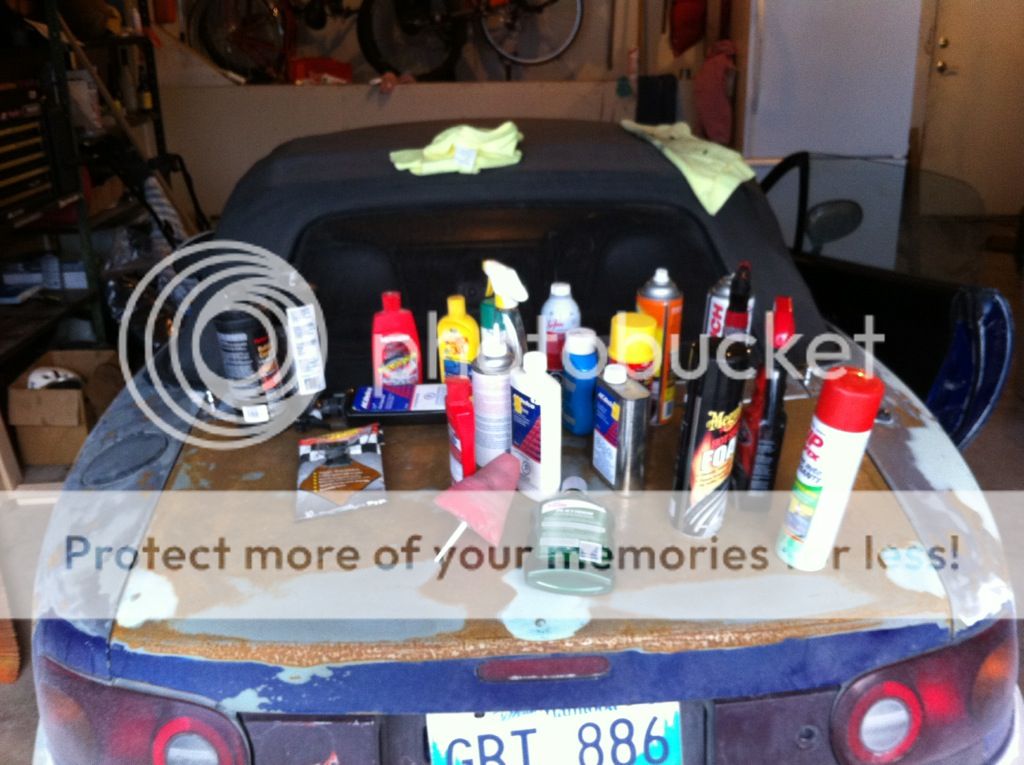

From there I stripped everything down to bare metal (except the swapped parts).  The door jams were not a fun task.  I welded in the antenna hole and the JDM side marker holes. I thought they looked like dinky trailer lights just slapped on the side for legalities in Japan so instead of buying usdm fenders, I welded a patch in.  While I had the welder out i searched for more repairs I need to do. Ended up finding a bit of rust on the rocker. so I cut and welded that guy too.
 The rear quarters had quite a bit of bondo and had been painted numerous times.  Once that was stripped, I pulled, hammered and dolly'd and straightened out the quarters the best I could and smoothed it all over to give it a nice smooth finish.  That is not an overnight task let me tell you that much.  While everything was down to bare steel, I rented a fender roller and rolled the fender lips.  Better to do it before you paint the car as then you don't run the risk of chipping paint. Especially if it's new.

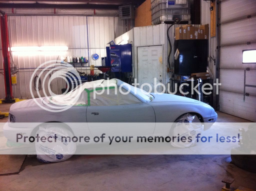

I washed her down, masked her up and laid on the primer.
 3 good coats of that and then began the sanding of the primer.  Once the primer was even everywhere and things were looking good, I saved up to have a buddy paint the car as I work as a mechanic now so I don't have a paint booth to use anymore.
I didn't want anything fancy but a good quality job to make the car all the same color and to have a durable paint that wouldn't peel off in 5 years.  Once I had that money, off to the paint shop it went. (a long awaited day that had me excited)
Paint Turned out pretty good for the most part. It's just a single stage paint so you get what you get.  I found 2 small runs in it but they are in unseen area's and the car is white. You can't see them anyway unless your looking for them on your hands and knee's under the car. (i'll show you if you come look)
(i took these pictures before I put the other side mirror on. I had somewhere to be so I took pictures along the way)
ha! just kidding!

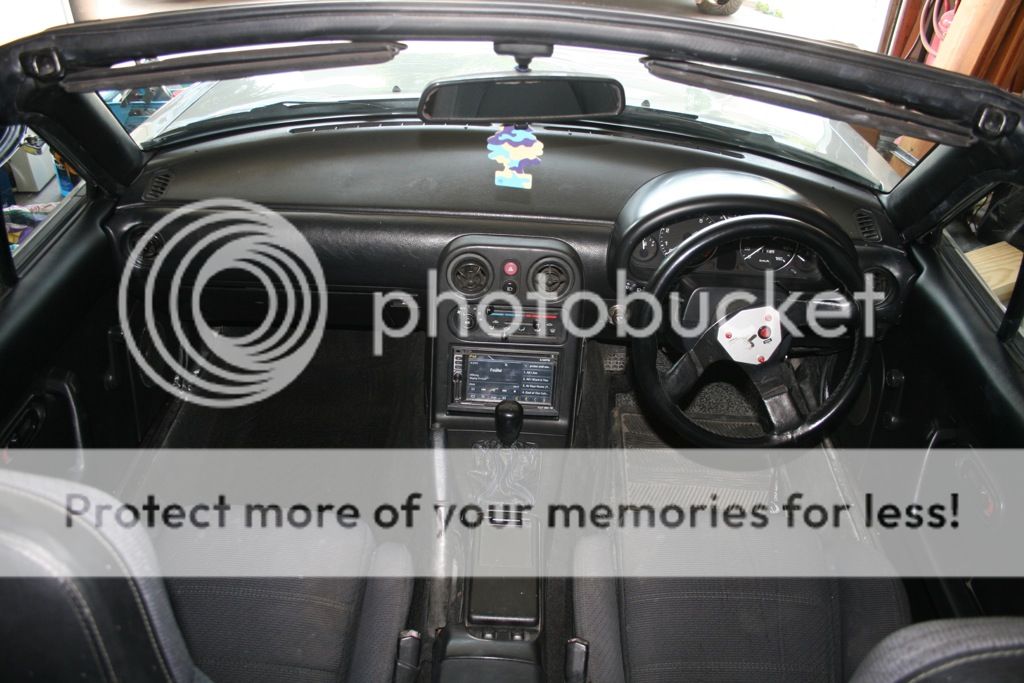

I also had some restoring of the interior to do.
The bezel around the gauges was busted so I bought a good used one (before i bought my parts car) from a left hand drive car. Thinking they were the same... I was almost right. When I got it, I went to put it on right away and soon found that it was a slight different shape then the right hand drive miata.  It had a pin 1” over from where the other one went into the dash. It's like they just kinda reversed the mold. So now I have 2 of those that I can't use.  I ended up buying one off ebay in the uk.  That was not a cheap endeavour either. Oh well, it's here now.  I also replaced the centre trim piece that goes around the radio.  The one in the car was broken too.  And then I took off all the weird red vinyl and some stickers that were ricing out the interior.
Lots of cleaning went down and now she's sparkly fresh.
The previous owner also put manual windows into the car. I guess he didn't like the old slow power windows that Mazda is known for.  The car came with a cheap aftermarket steering wheel but it hasn't given me any problems.  “If it's aint broke... Don't fix it” (unless your a honda guy!!! rip it all apart just because!!!! I used to be that guy so I can say that).

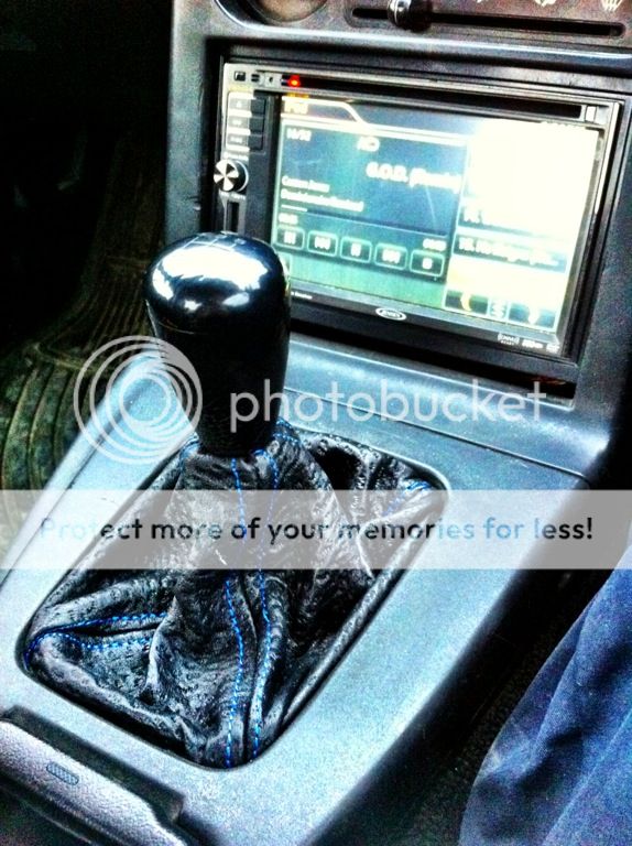

My mom is a seamstress and so I made myself a new leather shift boot with some blue stitching. I'm not the seamstress so it's not a fantastic job but it works just peachy.
