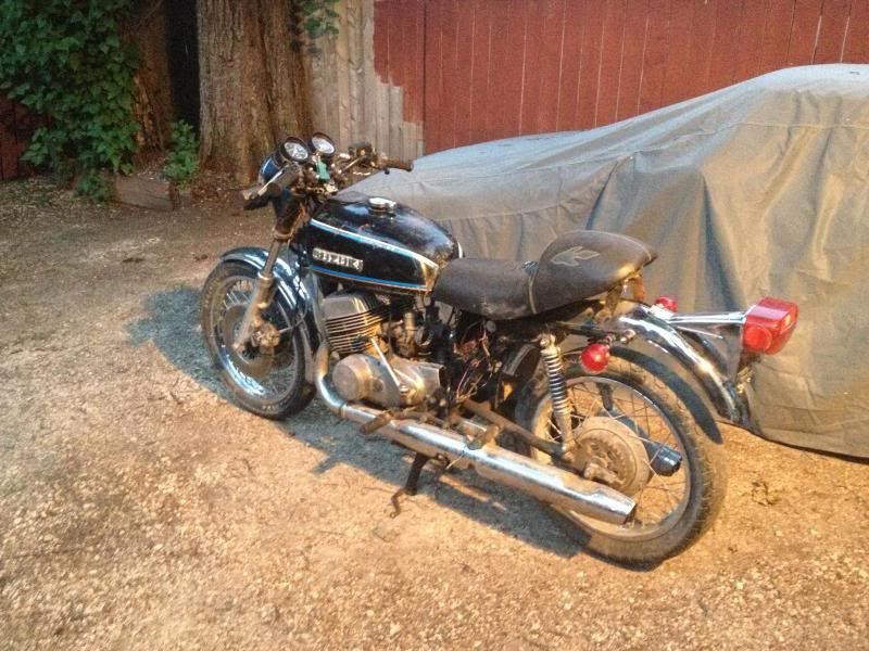

Tuesday rolls around and I decide to email a guy in grand beach about this old Suzuki GT500. He still has it so I arrange to come out Thursday and look at it.

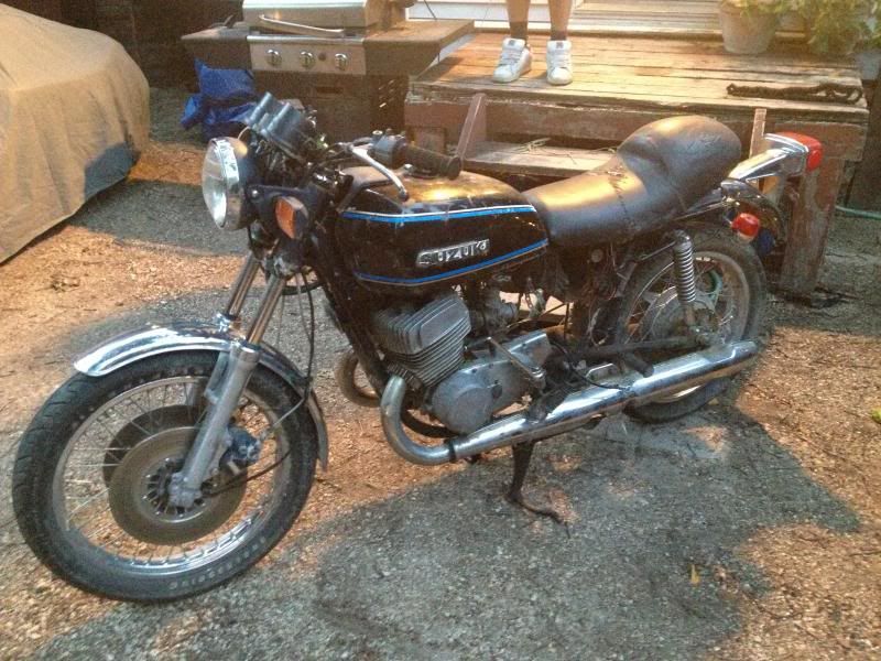

Last night me and my buddy hop in his truck and roll out to see the beast. It was in pretty rough shape, but I just saw the potential.
I offer the guy $150 and he accepts! So we load the bike up and off we go. Even though it is pretty haggard I am pumped.
We get back to my house about 9 PM and unload the bike. It is dirty, missing parts, and has the most awful seat I have ever seen in my life but its my bike! MY VERY OWN BIKE!
I present to you, my 1978 Suzuki GT500 (yep, air cooled 2 stroke!):

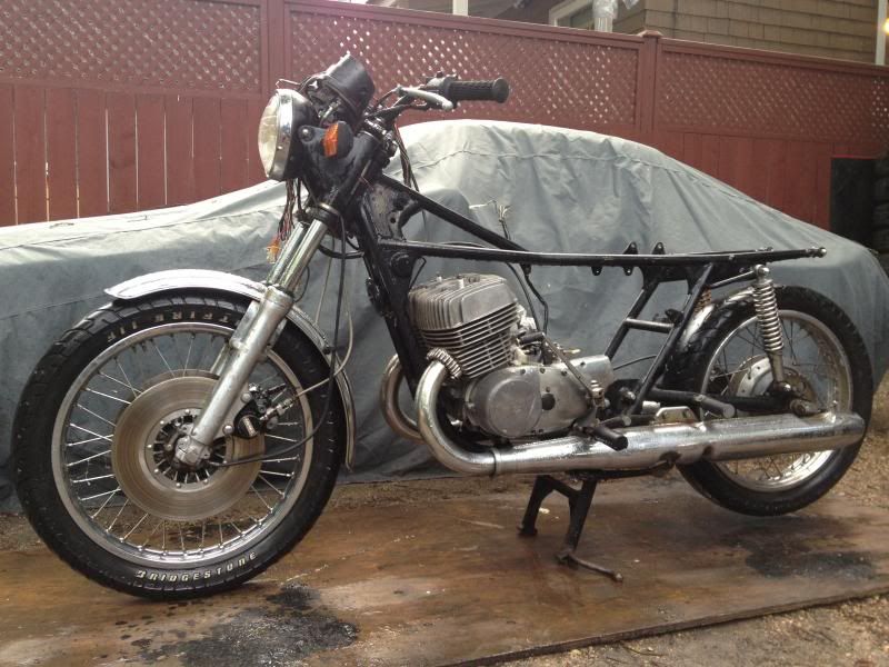

So after a good night sleep I went into work today but just couldn't wait to get off, go home and dig in. Overall the day went quick but it started to drag by late afternoon so I slacked off and printed these:

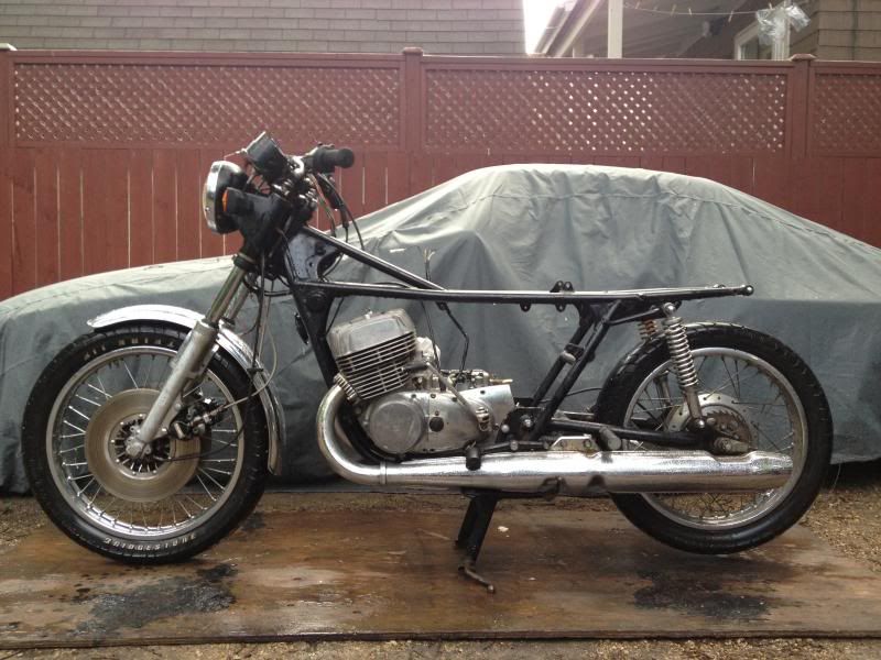

Got home, tore it down a bit to assess:
Its actually a damn solid foundation!!!
Tank is a bit rusty inside but I think it is usable! Seat is in the trash, and a custom one is being planned. Carbs are in great condition but will get a rebuild. Will need a bare minimum of coils, wires, plugs, foot controls and sprockets (looks like the chain spun around the rear one the last time it was running).
I really didn't have high hopes for the engine until I saw the sprocket, and after a quick compression test both cyls were reading 130+ psi. That's a good sign! Fingers crossed that the gearbox isnt borked.
I am not sure what the forks are from, but it has dual front discs. Through some reading, the GT500 never came with these. The brake lever is also slightly different so I have some investigation to do. Forks will also need new oil and seals.
