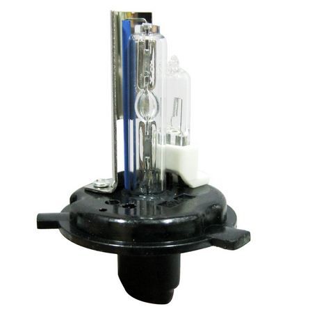

                    So to answer your question: Yes it is possible to make just the high beam HID in a 2005 Toyota Tundra. The Tundra uses a H4 dual filament bulb, I sell what are called bi-halogen H4 HID bulbs which have two separate bulbs for low and high beam attached to the same base. There is one HID bulb and one halogen bulb like in the picture below. I would not reccomend doing this though; this is because the small halogen bulb is often not enough light to light up the road in front of you and you may not even think your lights are on at night until you put your high beams on and fire the HID bulbs. Your call, though this is the only way available to do what you are asking...
                    Typically these bulbs would use the low beam as HID and the high beam as a daytime running light on vehicles equipped with high beam daytime running lights.
