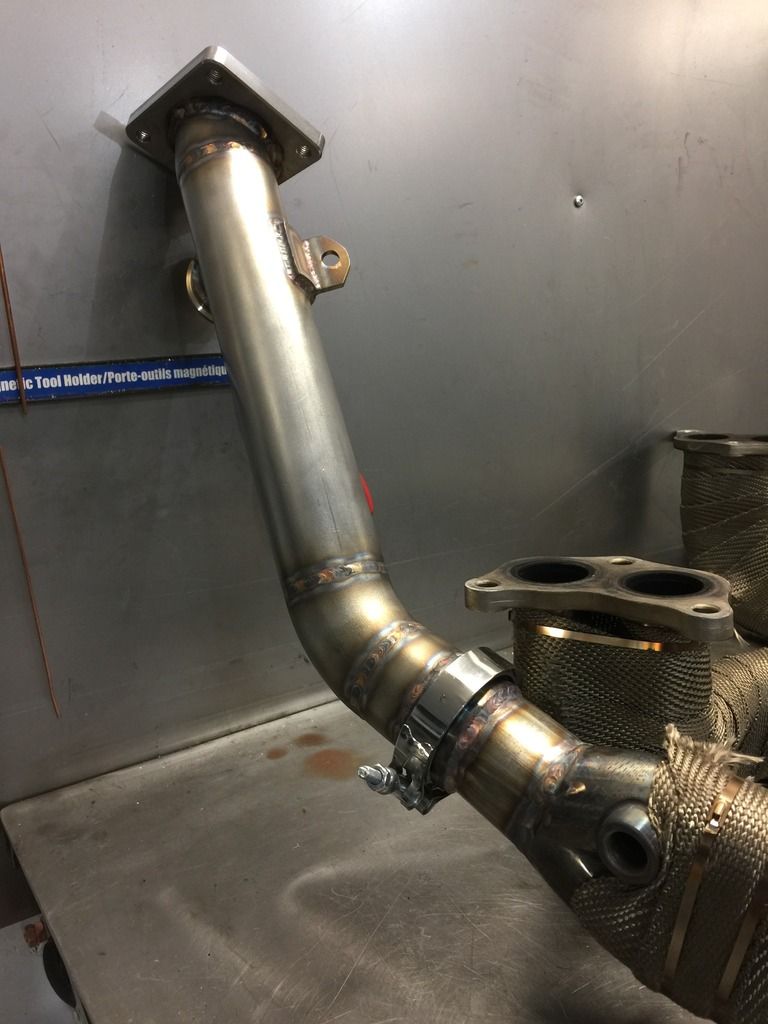

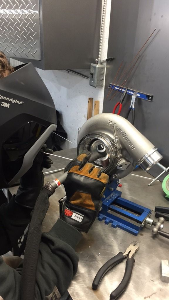

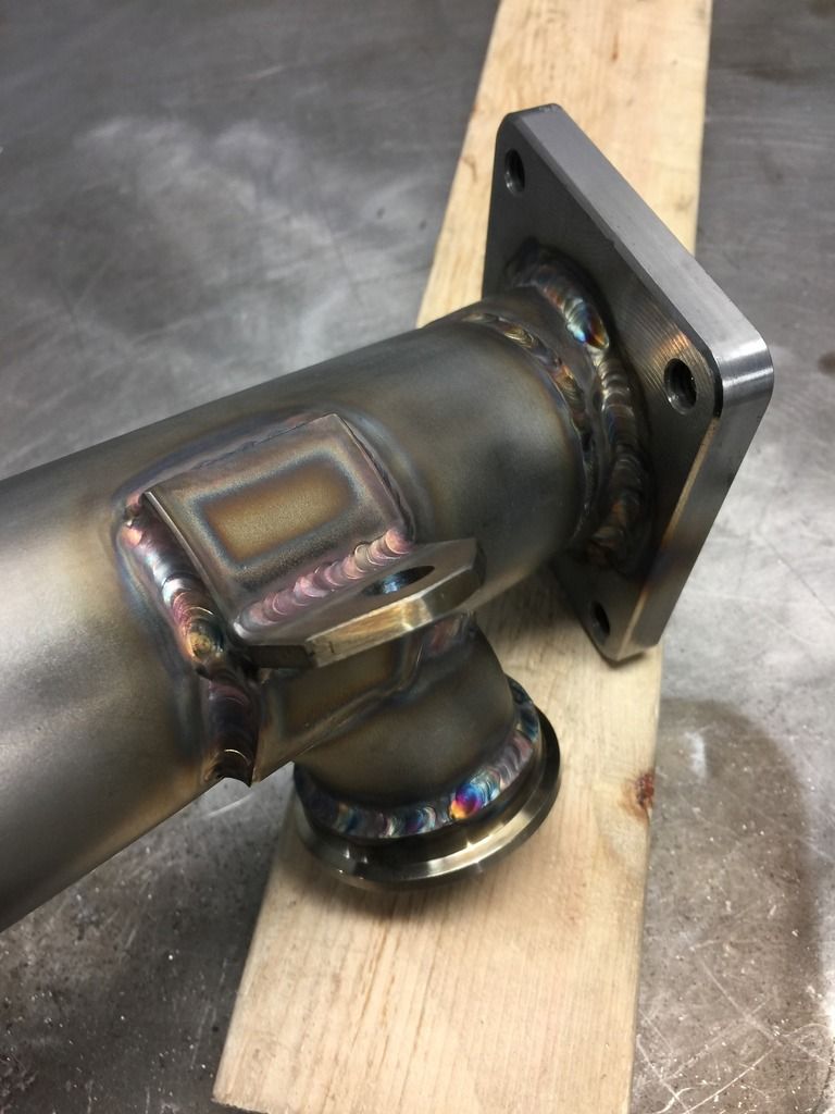

                                          Update:
                                          As usual, my projects get out of control.

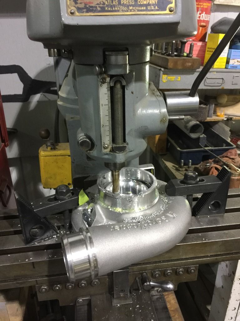

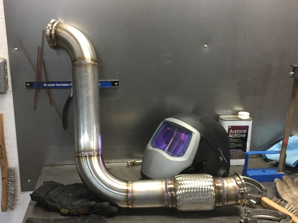

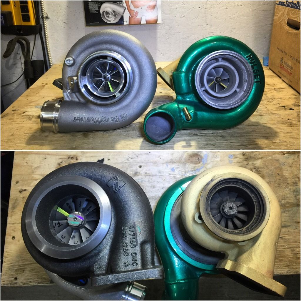

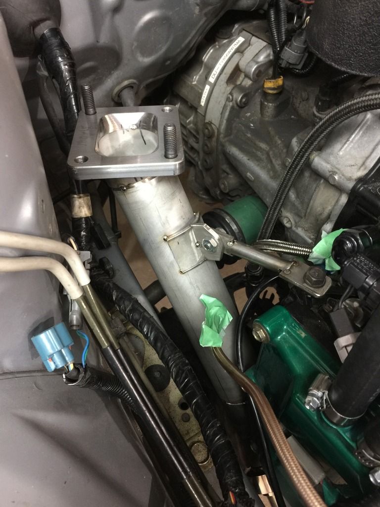

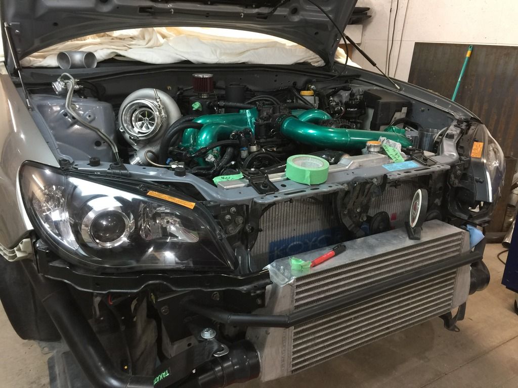

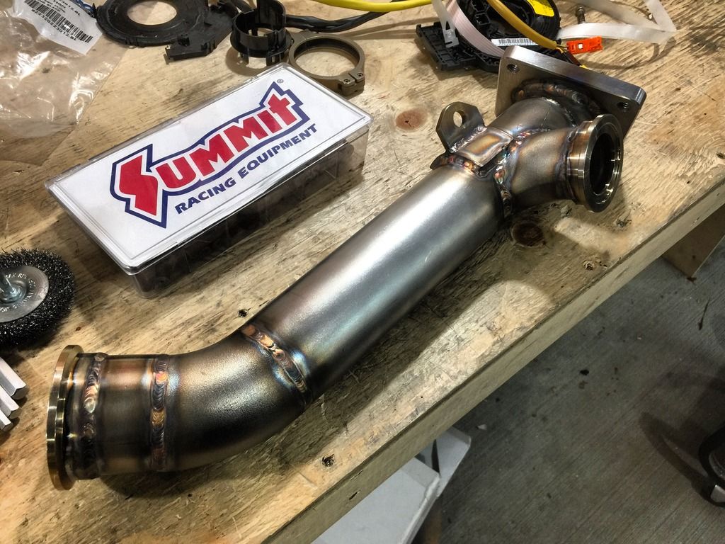

                                          My fab materials have all arrived and I have almost completed all of the piping. I decided to keep my tomei EL headers and modifiy them instead of building a set from scratch this go around. I cut the clumsy 3 bolt up pipe flange off and welded on a 2.25" v-band instead. Makes assembly a ton easier. I then made my up-pipe out of 2" sch10 304L with a cnc'd t4 turbo flange. It turned out great! Very happy with how the large turbo sits.
                                          I then went to work on the down pipe. I ended making in shorter than normal because I decided to add a 12" removable v-banded Vibrant resonator to tune the exhaust note a bit. The ease of install and removal with everything being v-banded is really quite the time saver!!! I then slightly modified my aluminum exhaust slightly to fit with the new piping. I bought an aluminum v-band flange that I tossed on the lathe to machine out an inner lip so it would seat nicely with the male lip of the resonator.
                                          Now I just have to build my new unique intake setup and things should sing quite nicely. This is where things are getting carried away even more than normal. I will list it in point form so that I don't ramble on forever. I also welded a 4" aluminum v-band flange to the compressor cover inlet and a 90 degree elbow to the outlet.
                                          Here is a neat comparison of new vs old.

                                              Update Time!
                                              As usual, I was under the crunch to get the car back together before heading to Calgary for the tune/Driven. The bay shave/tuck was extremely time consuming but it is also very satisfying now that it is completed. I then had one hell of a time with my brake lines. I tried hard lines at the beginning that were a nickel/copper alloy but couldn't for the life of me make a good double flare. I then decided to quit dicking around and bought all AN lines for the front of the car. Everything is tucked so no brake likes are visible in the bay other than the 2 right off the master cylinder. I also decided to switch the color of my powder coated cr2p's from a heavily flaked black to a very cool chameleon lemon lime. I am much happier with this color and it looks great with my powder coated and rebuilt calipers!
                                              Once it was all together I drove gently around the city to break in the new clutch before seeing sunny. Soon after, it was time to load the car onto the trailer and head to Calgary for a busy few days. We showed up at Vex/Airboy Tuning 2 days before Driven for what I was hoping to be a quicker tuning session that last time. That wasn't the case. We started with having to remove both bumpers to properly strap down the car, then the tires were too soft so we nascar style swapped them over to another set that Sunny had. Then if that wasn't enough, we started having fuel pressure issues. We ended up replacing the FPR, fuel filter and fuel pump. Finally the fuel pressure was rock solid! Each pull was gaining around 40whp and the grin on my face grew. We finished up at around 10:30 pm with 506whp and 430wtq, but sadly we were still just a meager 3whp away from the dyno's Subaru record of 509 whp. Sad I know. Everyone was extremely surprised by the power it made and I was extremely pleased haha. We unloaded the car, reassembled it, chatted with the shop guys for a while and then took the car out for a midnight drive to see what a true 500whp Subaru is like. Needless to say, its pretty darn fun. It even shoots flames out of the hood, which the child in me absolutely loves. The turbo definetly takes some work to spool, but I like it actually. Allows me to drive like a normal person until I really want the power. Plus a rev to 8k which makes it great.
                                              Then came Driven 2 days later. It was pretty much a mad dash to clean the car since is hadn't had a wash since November. The show was amazing and there were many amazing cars there. I was lucky enough to be awarded Best Subaru in Show, even without any sort of entertainment system what-so-ever. It was a great feeling!
                                              Now we are back in Brandon, planning the next round of mods to come! Cough Cough standalone/ethanol/650-700whp
                                              Now for some pictures.
