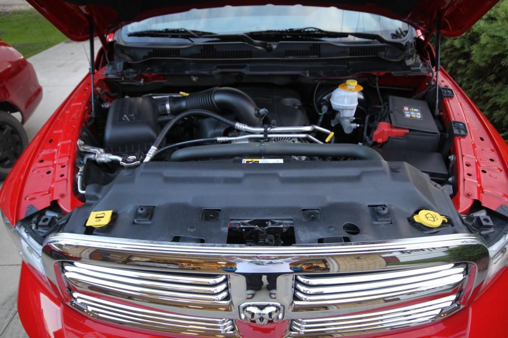

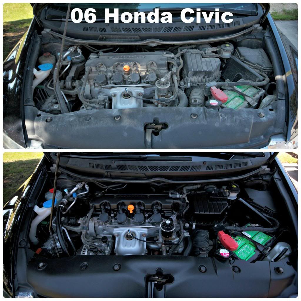

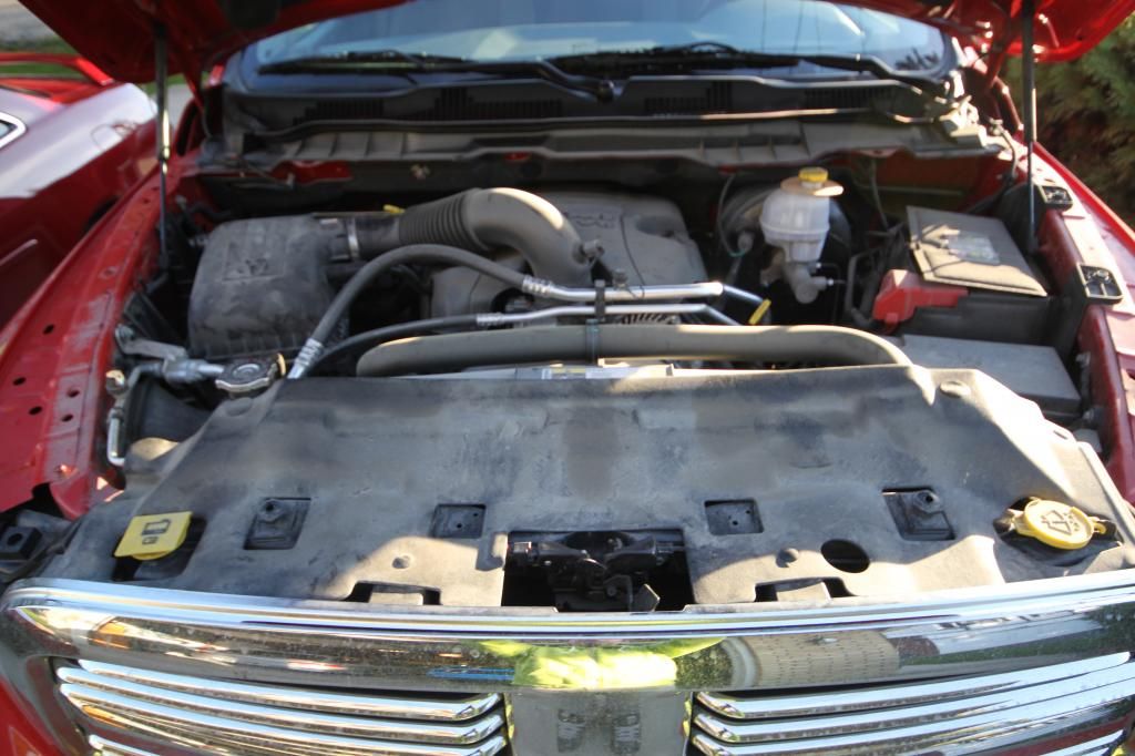

                  I use a combination of low pressure water, high pressure steam, various brushes, and Chemical Guys Signature Series Engine Degreaser.
                  Cover up any sensitive electronics (distributor, fuse box, etc) with plastic bags and tape them off so they hold still.
                  Rinse the engine down with low pressure water.
                  Divide bay into quarters and soak one quarter at a time in degreaser, while agitating it with brushes. Rinse that spot off, and move to the next quarter. You want to do this as to make sure the degreaser doesn't dry (as it could harm the plastics).
                  Any tight nooks and crannies, I use high pressure steam to blow it out.
                  At the end, put a engine dressing on to create some nice contrasts with the blacks, and you're all set.
                  Here are a few examples of mine.
                  F150
                  '06 Civic
                  '13 Ram 1500
                  To me, a clean engine bay is just as important as having the rest of the car clean!
