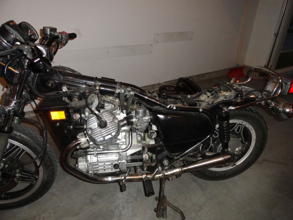

                            added lower shocks today...
                            pics to follow... almost done and ready for safety.

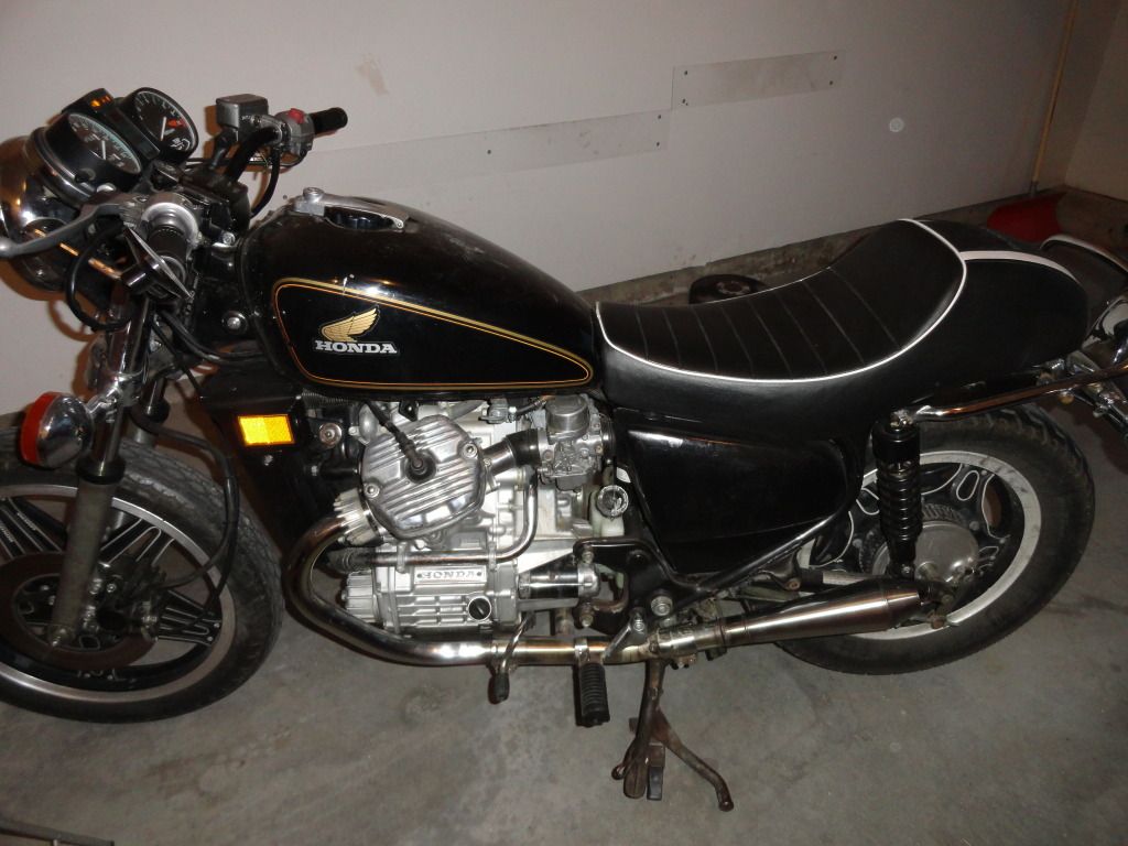

                                  almost doonne!   ...for now.  have a fender, mikunis and led lights to go on yet, paint this winter.

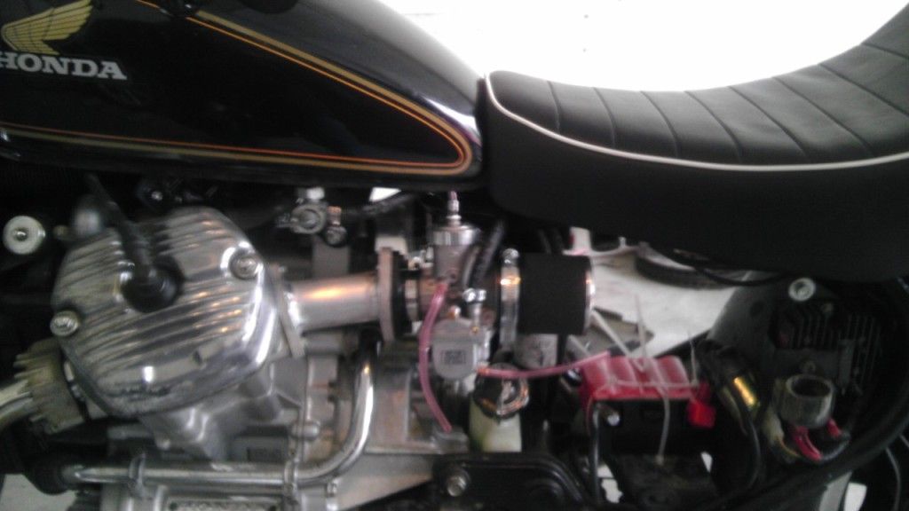

                                          September 21, 2012, 12:24 AM #45
                                          • Posts: 645
                                          Moar pics!!

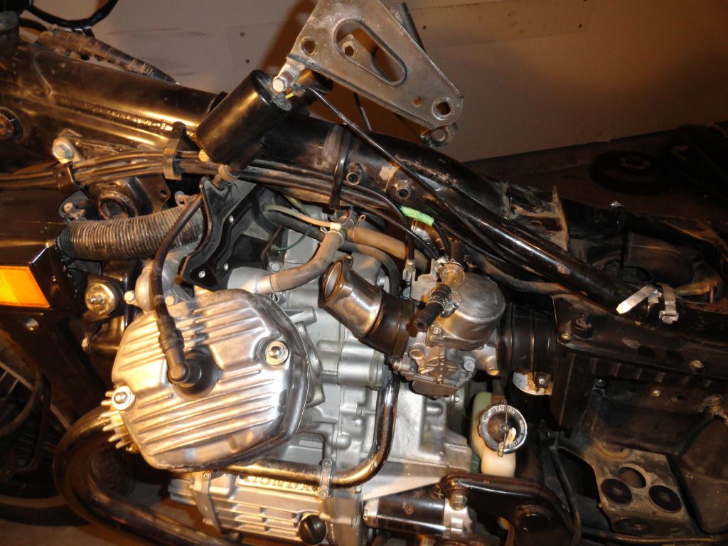

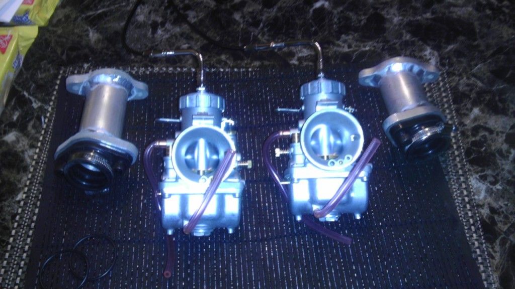

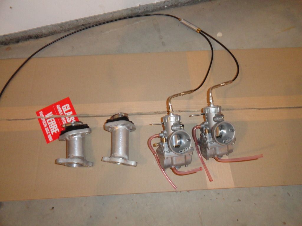

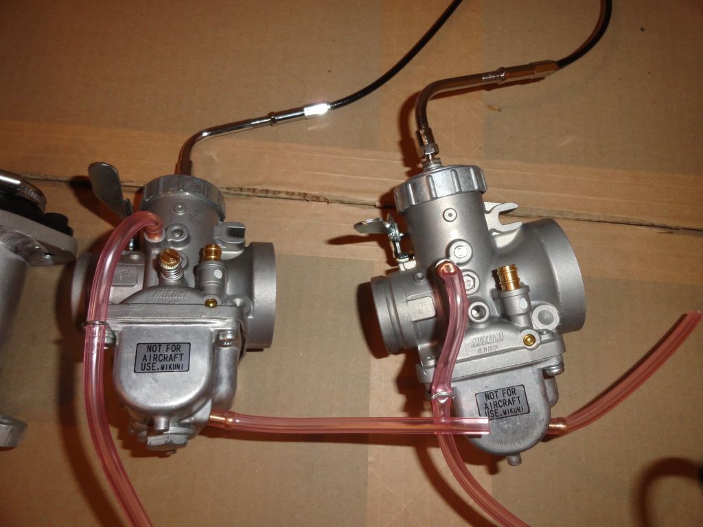

                                          installed Mikunis VM34s, removed stock airbox and battery replaced with ballistic's battery (1lb); lost 20lbs in that process...
                                          Carbs and new intake (prototype from the us of a) dyno proven for +18hp... (30% increase over stock) this is a different bike now, amazing.
                                          so on to the pics...
                                          quality is bad, but whatever... I'm not pro.

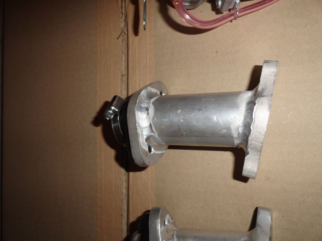

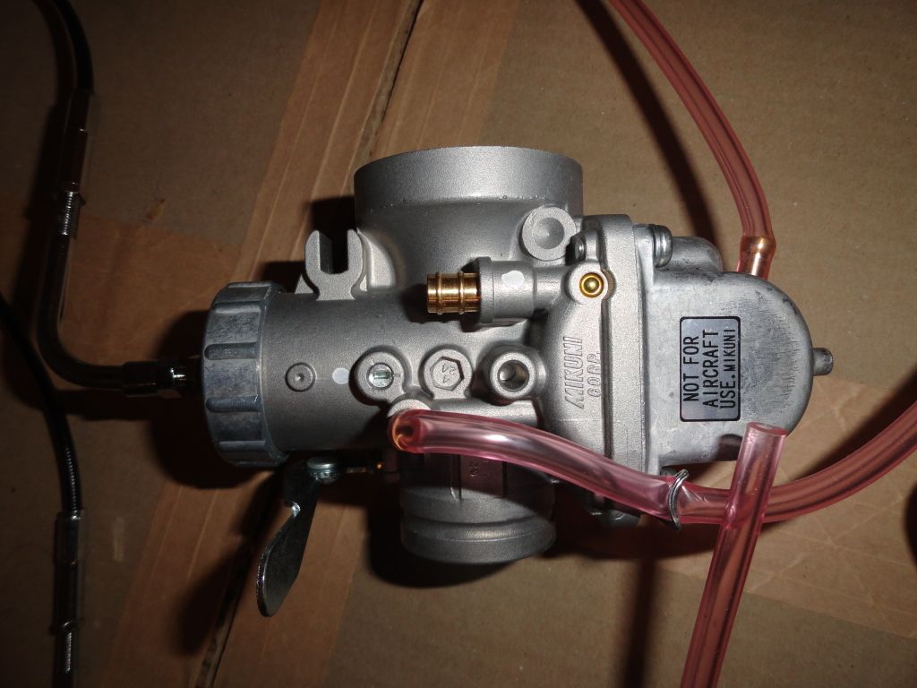

                                          Carbs and Components of kit:
                                          start...

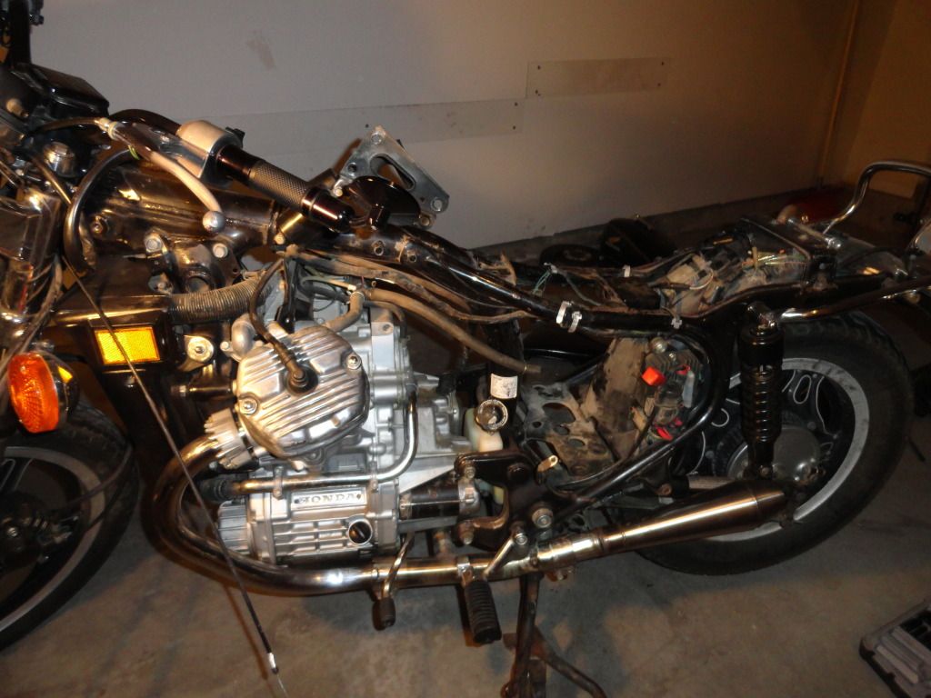

                                          Bike getting nakeder
                                          Removing Engine Mount
                                          Intakes Removed
                                          Airbox, intakes removed...

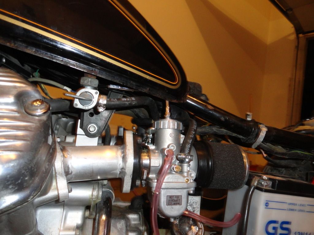

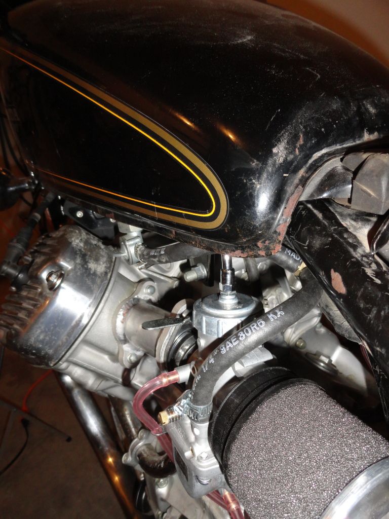

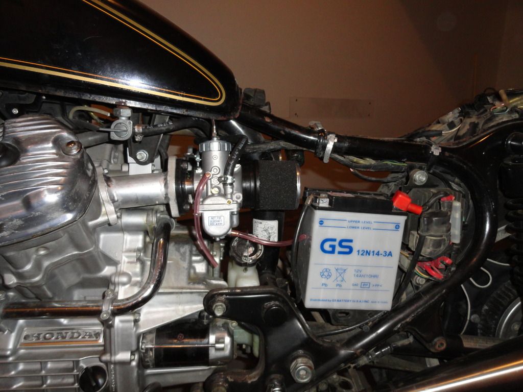

                                          Carbs Installed:
                                          Bit tight on the clearances:
                                          Somewhat finished; Well, running now:
                                          I have since replace zip ties with a metal strap, but I will be moving all this stuff under the seat to clean it up...
